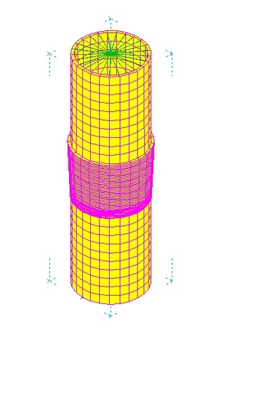

Can anybody help me. I have got stress in X and Y direction with SAMCEF software (I use cartesian coordinate systems) and i would like to deternime the hoop stress. Can anybody tell me how to get hoop stress from principal stress (X and Y).

My model is a cylinder under pressure and i would like to determine hoop stress from x and y stress

This is my model. I have found that (in one element) X stress = 67.7 MPa
Y stress = 334 MPa
Z stress = 11.1 MPa
How can i calcul hoop stress ?

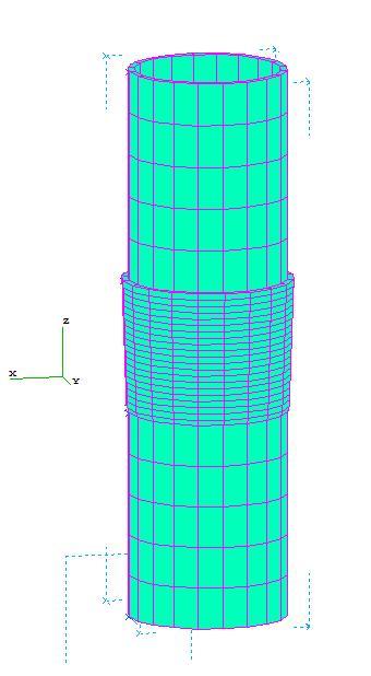

I would like to calcul stress in element num 218 as shown in thee figure.
[cos theta -sin theta 0 ]
[sin theta cos theta 0]
[0 0 1]
To obtain stress in cylindric cordinate system should i multiply this matrix * the vector [ stress (x), stress (y) , stress(z)] to obtein the stress in cylindric system?

Given your latest sketch of the cylinder (your 30NOV15, 16:58 post), why don’t you consider the following. At any given Z plane (latitude), and in (or very near to) the X plane, won’t the Y stress component be the hoop stress? At the same Z plane, and in (or very near to) the Y plane, the X stress component should be the hoop stress, and it should be essentially equal to the Y hoop stress you found previously. At any other location on the circle you have to do some adjusting and summing of the stress components (X & Y) to transform them to be pointing in a radial and circumferential direction. The Z stress component should be the same all the way around. The above, assumes of course, an infinitely long cylinder in the Z direction, without any anomalies which cause significant stress changes. You shot a major bull when you modeled this cylinder by not taking advantage of symmetry, by not placing the Z axis at the center of rotation of the cylinder, and by not using polar (or cylindrical) coordinates to model it. Remember, a computer program does not a thinking engineer make.

with such lousy results, pick an element where the global axes align with the hoop direction. previous posts about using vector summing also apply.
RE: Hoop stress
sna1 - yes, that is the vector transform.
