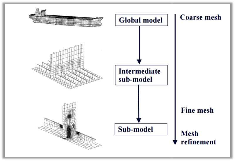

Hi all,
Thanks for the conversation. I've been testing Ansys, but it hits a wall when the size of the model gets too big.
I'm modeling a FPSO by the way, the whole boat in its real condition (with cracks, corrosion, etc.). So I have a coarse mesh in the global model (t10 DNV-RP-C206 for the ones familiarized with DNV standards), and several sub-model with fine mesh (t3 to t1 mesh refinement).
But I really need to go to the next step, simulate the entire model in full detail (condition-based modeling). I have looked at a solution provider in the web, but haven't dare to test it yet. You can check out their website and tell me if you know about it: www.akselos.com
And, any other options to build a 1000 mdf condition-based model ??

RE: FEA software for very large structural analysis with defects
That company appears to just be automating what good FEA users already do manually. They are passing it off as improving the solution of huge models, but their algorithms simply reduce the size of the model with out telling you by converting things to superelements and submodels automatically.
You could do this is nearly any of the FEA packages that you mentioned and you would also have the benefit of using rigorously tested codes compared to this where it could be anything goes.
