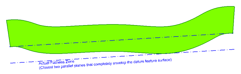

Woosang,
Here is a figure, that I adapted from a different thread. The lower surface is the datum feature with the flatness tolerance, and the upper surface is the considered feature with the parallelism tolerance:
This is a case in which the boundaries of the flatness zone do not coincide with the datum plane.

RE: Flatness tolerance zone is parallel to Parallelism tolerance zone?
Thanks Axim,
My misunderstanding was apparently due to that I thought that the one end of flatness tolerance zone is a plane which contact to a surface at its highest points, which is not true.
But Y14.5 seems do not have clear description for that.
Woosang,
This is a common misunderstanding. The figure in Y14.5-2009 shows the tolerance zone contacting the surface at its highest points, which is misleading because it doesn't need to. There are also GD&T textbooks that show an inspection method for flatness that involves laying the part on a surface plate to establish one plane of the tolerance zone. This is even more misleading, and could result in a false nonconformance on the part that I sketched.
