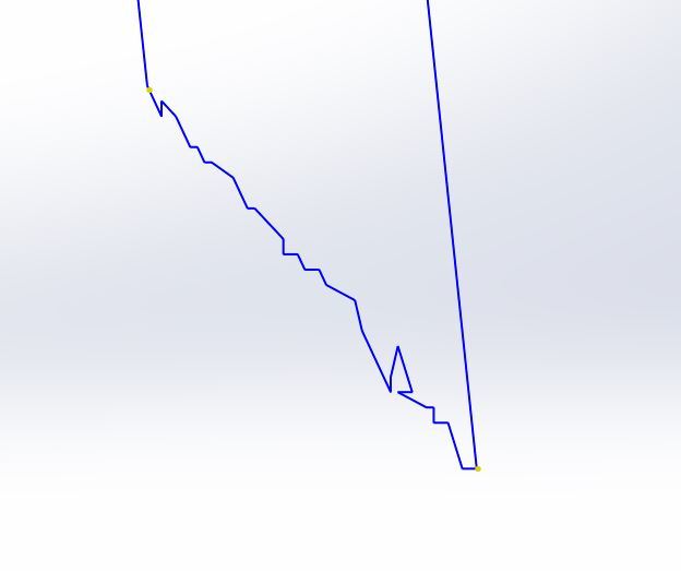

Thanks I've managed to clear up most of those but there is 1 point that I still cant get to resolve.
No matter how far I zoom in I cant see the issue.
RE: Conflicted item in sketch
when I zoom into that last area i see this
I would probably do something like this in two sketches: first a layout and then a final detail. The layout would have complete circles instead of broken concentric circles. I think the solver is getting taxed by the multiple coradial circles and close endpoints. Then the detail would be constrained to the layout.
I found it :D I couldnt see due to the contrast on the monitor. Yellow on white not so good for my eyes.
