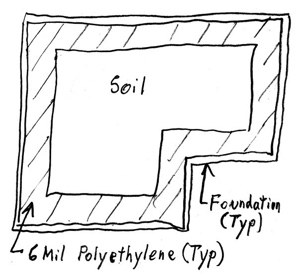

Another help is 6 mil polyethylene sheet placed on top of the crawl space ground, around the inside perimeter of the entire crawl space. Keep the sheets within, say 3' to 6' of the foundation wall. Don't cover the entire crawl space; that will effectively trap moisture under the poly... but poly is a barrier not a sealant. Summer time moisture will continue to be a problem. By keeping the center of the crawl space uncovered, moisture can escape from the soil and be expelled by the blower.

SlideRuleEra: Interesting how you would run the poly. I have had many people tell me when I put down the poly to cover the entire crawlspace floor, but they also weren't mentioning installing a blower in the crawlspace. I have a call in to a Geotech. I will see what he has to say and report back here.

Mayfield - Just place the poly sheets along the foundation walls as shown in the sketch below. At the center, be sure to leave at least half the square footage of the crawl space uncovered. Overlap the poly joints, no need to tape them or to run the poly up the foundation walls. In cold climates, I understand that covering and sealing the poly over the entire crawl space works well. In central and coastal SC, summer humidity and cooling is the issue. If the crawl space is completely covered in these regions dehumidification works too well. Summer moisture is much improved... but in the winter the house drys out too much. The floors and woodwork shrink & crack, furniture comes unglued and can even fall apart. I've seen that happen. This result is not that dramatic with a modern HVAC system... but not everybody has a modern system.
With all that said, the intelligent blower (and appropriate perimeter inlet vents) is most important. I would try just that first. The poly can always be added later, if needed.
