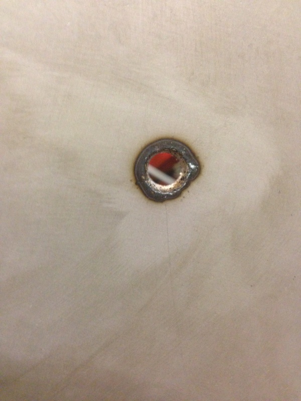

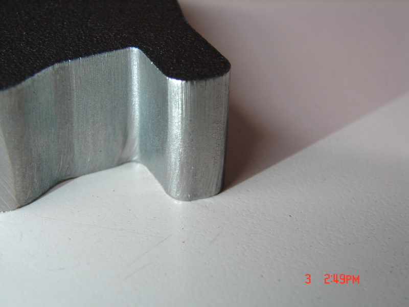

Hi.
We are cutting 20mm mildsteel with some small holes size about 9mm and they are right size for about 3/4 deep then they get larger.
Cutting with 10Hz , Current control, speed 100mm/min gas 1bar focus +2,5 nozzle D24 1,5mm standoff 1.5mm
What should i do too improve the cut quality?

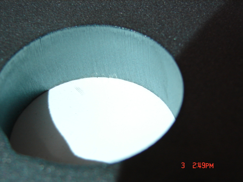

Do you have à picture of the cut on 3/4? How much tapper do you have?

I checked this part and the difference between the top to the bottom is .005.
RE: Small hole processing 20mm thick, Amada X1 (LVplus)
What should i change to decrease tapper at the lowest 1/3-1/4 of the cut?

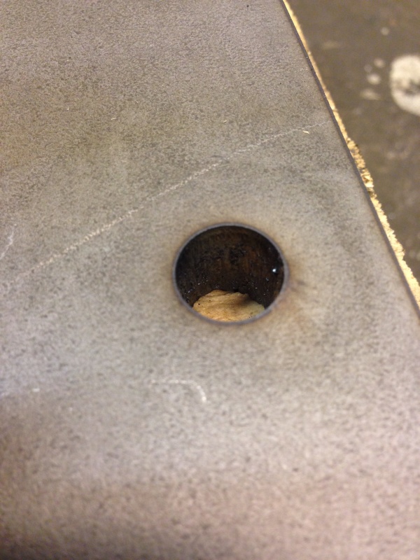

I have no idea what your experience with cutting is so I will treat it as if you work with me. It looks like you have a few things I would adjust but you will need to do them one at a time so you can see if the changed helped. The first thing I would adjust is the gas pressure, I think you said 1 bar, we run at .5 so try that and see what it does. The focus looks high, you said 2.5 mm (.100) we run around 2mm (.08). This is just a few things you can try but the quality of the material is a major factor. Gr50 cuts so much better that A36 and the scale on the top of the sheet will also kill the cut.

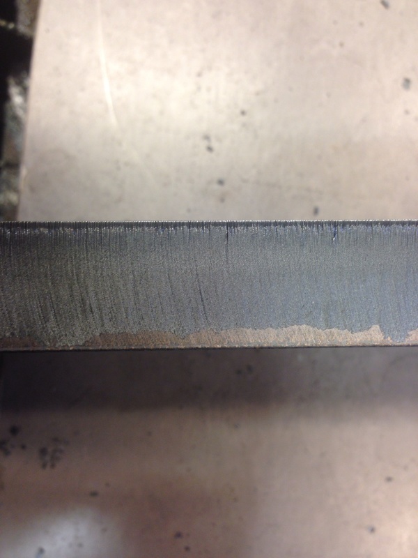

Tested with lower focus but got problems when piercing and no better cut.
Lower gas pr with a little better cut.
Hole size at pic is 12mm. Not cutting small holes as good as in 15mm thick.

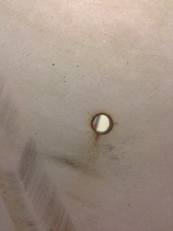

With thicker material, we found that using a larger lead in with a radius gives a better hole.
Cut some more today, changed to cutting holes with more standard cutting instead of low hz type cutting. Added more lead in and also added a small joint too get less burning at end. Holes at 12mm are good, but 10mm still have some adjustments.
Have cut some more 20mm the last days. Lowerd the nozzle high and reduced gas pr.
Speed 850mm/min gas pr 0,6 focus 2.0
Should i try too increase speed? Or do you think i should be pleased with the cut?
Look at the curve of your cut line if you go faster the bottom may not keep up with the top so with your setup your feed is fine. You have a good quality cut that any customer will be happy with so run with it.

Thanks for your answer. We cut a sheet for 4,5 hour today. Total of 180 12mm holes. No fault or stops.

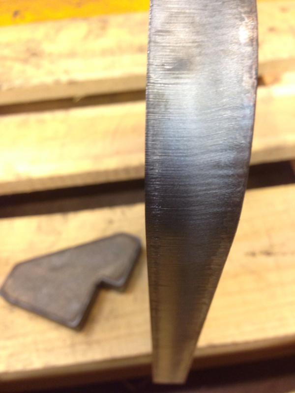

8,8 mm holes. Not much tapper. Front vs backside.
No problem make 1/8"G in it.
From experience when we started to cut 20mm, any hole we cut, we made sure the lead in was as big as possible. Our Dr.Abe software usually suggests what lead in is required, along with the radius prefered also.
So try a longer lead in, and try it with a radius.
Put a 8.8 drill in it too check backside size.
