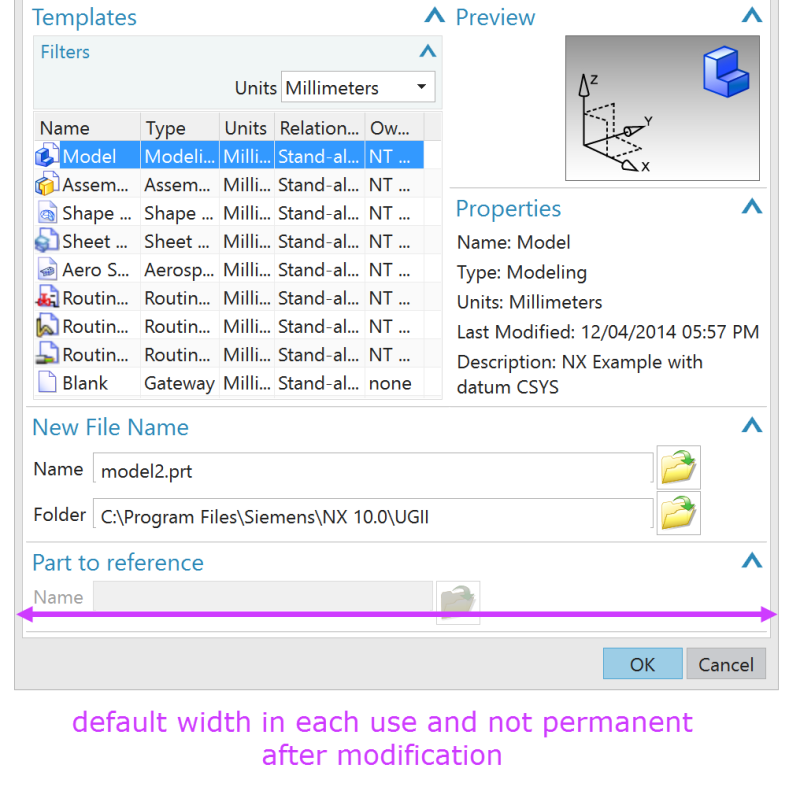

I used some settings but yet I cant get good result. menus cant keep standard ratio and some icons are too small.
I attached some screen captures

except the size of icon and text, another issue is the boundary of options that can not be moved.
for example overall text field is not visible and using horizontal slider every time maybe boring.
and new command:

Then I would contact GTAC with that and have them open an IR/PR.
