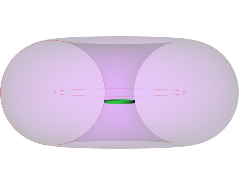

We are currently dealing with an issue where I work and it is regarding the degrees of freedom constrained by a toroidal datum feature used as primary. To be specific, it's not an entire torus, it's just about 7 degrees of the subsidiary radius but all 360 degrees of the main radius. It seems to me that this constrains 5 degrees of freedom but unlike a cone, there is a point and a plane, not a point and an axis, from which to take measurements from. My idea is that the thing that constrains u and v rotations is the spine of the torus but I'm getting some resistance to it.
What are your thoughts?

A toroidal surface would constrain 5 degrees of freedom if used as a primary datum feature. All but the 3rd "clocking" rotation would be constrained.
I'm not quite sure what is meant by the "main radius" and "subsidiary radius" - can you clarify?
The datum feature simulator would be a perfect inverse toroidal surface. The datum is less clear - the toroid doesn't fit exactly into any of the feature types shown in Fig. 4-3 of Y14.5-2009. The closest one is (e) with the axis-and-point datum, even though the feature isn't conical. You could also use a point-and plane datum, or an axis-and-plane datum (provided that the axis is perpendicular to the plane). At the end of the day, the important thing is that the datum constrains the correct degrees of freedom of the coordinate system - in this case, everything except rotation about the "axis" of the toroid.

The main radius would be the radius of the spine of the donut and the subsidiary radius is the radius of the cross section of the extrusion. This is what Calypso calls the features anyway.
I don't see that a torus would have an axis which is why I'm kind of hung up on the point-plane scenario, but I see your point about what the datum actually is. That's the reason for this post. I'm inclined to recommend a change to the drawing simply for purposes of being able to repeatably check the features as well as not requiring a CMM to check it but that would get away from the actual function. This is one of those cases where dimensioning and tolerancing exactly according to function results in a difficult--and unreliable, IMHO--inspection.

Perhaps this is not exactly how ASME phrases things, but here's how I look at it:
Rotation and translation are not constrained by points, planes, or axes, but by the relationship between the actual part surfaces and the datum feature simulators. Based on the datum feature simulators you can construct a coordinate system to take measurements in. Depending on the datum feature references, the coordinate system may or may not be completely constrained relative to the part.
If you have only one rotational DOF unconstrained, you can still construct certain geometry that is fixed relative to the part: an axis (at the correct orientation and location), points (anywhere on the axis), and planes (perpendicular to the axis). I think the point+plane and point+axis options are equivalent both mathematically and GD&T-wise, but I find the concept of a complete but partially unconstrained coordinate system is much more useful instead.
In the case of your partial torus, I'm not sure exactly how the datum feature simulator would work. Which 7 degrees of the subsidiary radius are used? How is the surface toleranced? Is the datum feature referenced RMB, MMB, LMB, or BSC? Some or all of these aspects might affect the answer.

I've sketched a toroid with a three different 7-degree sectors shown in green - at the "top", "inside" and "outside". Which one is most like your part feature?
Because 7 degrees is such a small fraction of the toroid, none of these would constrain all 5 of the degrees of freedom reliably - perhaps this is the source of the disagreement over the appropriate datum. The "top" feature is almost planar and would not constrain x and y translation well at all. The "inside" and "outside" features are almost circular and would not constrain u and v rotation or z translation well. This is a case where the theoretical constraint and the real constraint probably don't match very well. Technically, the feature constrains 5 degrees of freedom, but only 2 or 3 are fully constrained and the others are "weakly constrained". Y14.5 does not currently address these situations well.

It's more like the inner but moved down, and thus out, a little. Also, I was wrong about the 7 degrees. It's actually 3 degrees. The cross section diameter (like o-ring cross section) is 10 inches and the spine diameter is 12.780 inches. With such a tiny piece of the torus and such a large radius, the surface pretty much looks conical. If you created the torus with these specs and moved the center sector down .885 inches from the center of the torus to the center of the sector, you would have my datum feature.

Something like this?
Evan Janeshewski
www.axymetrix.ca
RE: Torus as primary datum feature
Yup. That's it!
