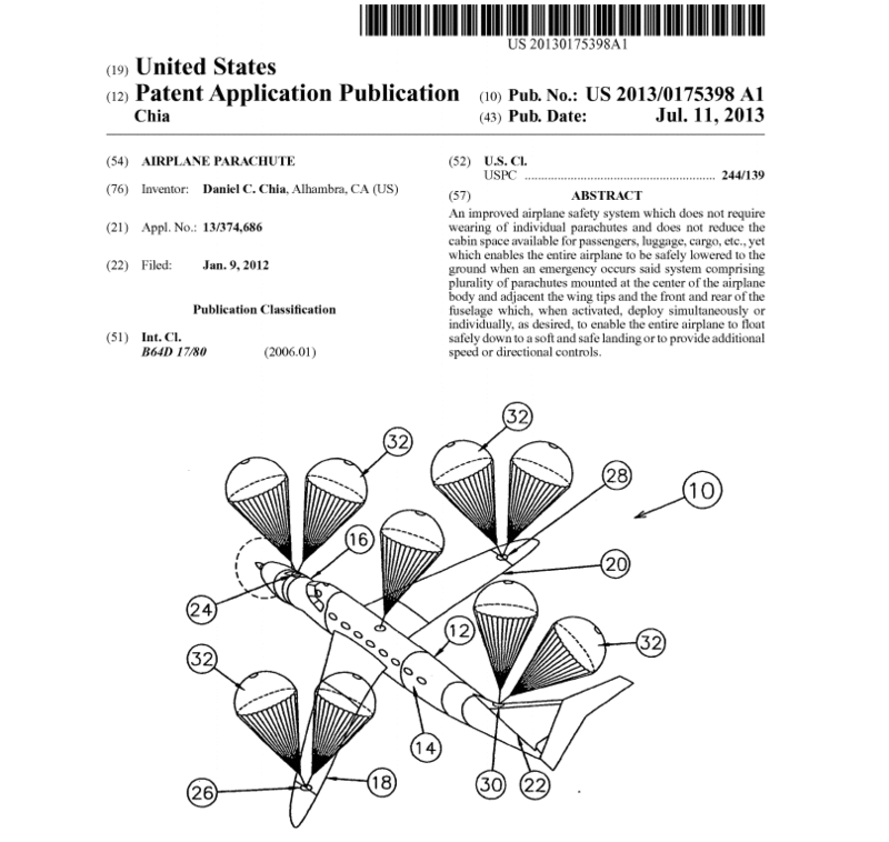

Hi everybody,
I've recently received a link which shows a patented system for safety of aircraft passengers. Is this applicable or just a flash from a non-expert person's mind?[highlight ][/highlight]

double the cost
double the weight
probability that system won't work when needed: high
probability that system will cause other problems when not needed: moderate
Just because someone patents something, doesn't mean it's feasible or practical or even realizable.

Weight is everything for aircraft. The swing-wing US Super Sonic Transport of the 1970's was largely doomed by the weight of just the hinge joint in the wings even though it would have greatly reduced the landing speed and improved fuel efficiency when at lower speeds.
Complexity results in more issues, higher costs, and higher weight. All electrical and environmental cables would need mechanisms to detach from the aircraft. Atmospheric pressure would need to be maintained in the capsule after separation. More mechanisms, more systems, more weight. more possibilities of failure and dead passengers even if the capsule successfully ejected.
Weight affects fuel costs. Complexity affects acquisition cost, training costs, maintenance costs. All of these are big issues for commercial carriers who shave pennies for savings to remain (hopefully) profitable.
Better to look at the simpler safety system that are available - ballistic parachutes for the whole aircraft. I'm not aware of any large aircraft that are equipped with these, but many small private planes and ultra-light aircraft are, and they have saved lives already. Even when the plane was OK but the pilot was just disoriented and unable to fly the aircraft in the weather conditions these have saved lives.

Modern commercial aircraft are already incredibly safe to fly on. In fact, you are probably safer traveling on a modern commercial aircraft than you are using any other form of transportation. Adding all of the additional complexity involved with that system would only reduce reliability.

IMVHO ... what an absolutely stupid concept ! to have the passengers all in a cabin that can be ejected from an airplane. How would it land safely ? what about the pilots ? how would passengers in their seats react to these very different loads ??

That's actually my optimistic scenario; I'm imagining parachutes failing to deploy and the plane was too low to have proper parachute deployment any way, and the pilots and plane successfully ditch in the river while the passenger cabin is strewn across the countryside.

There are many designs in aviation that never make it past the conceptual phase. It isn't that this system couldn't be made to work, but aircraft design is driven by the economics of new technology. As others have said, this solution would add a considerable amount of weight to an existing airframe design, which means increased fuel consumption, lower available payload, and major retrofit costs. Overall, I'd say the only applications could be for military or special use aircraft.

Looks like air conditioning, electrical, pneumatic, ground servicing connection mess.
