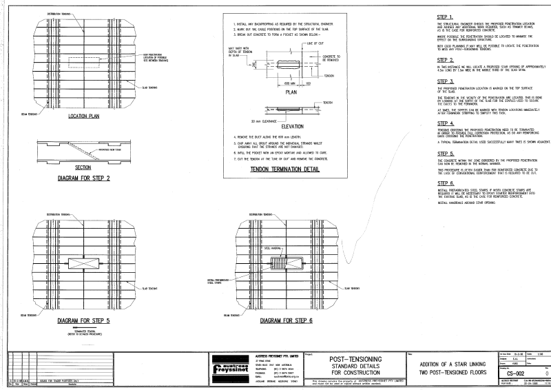

The UK-based PTA is worth looking at: PTA Link
The PTA has a guidance document entitled "Post-Formed Holes Through Post-Tensioned Slabs" that is attached to this post.
And as Trenno stated, the Australia-based PTIA has several download documents on the subject.
There is also this presentation entitled Truncation of Post-Tensioned Tendons that you can download here: PTIA download Link

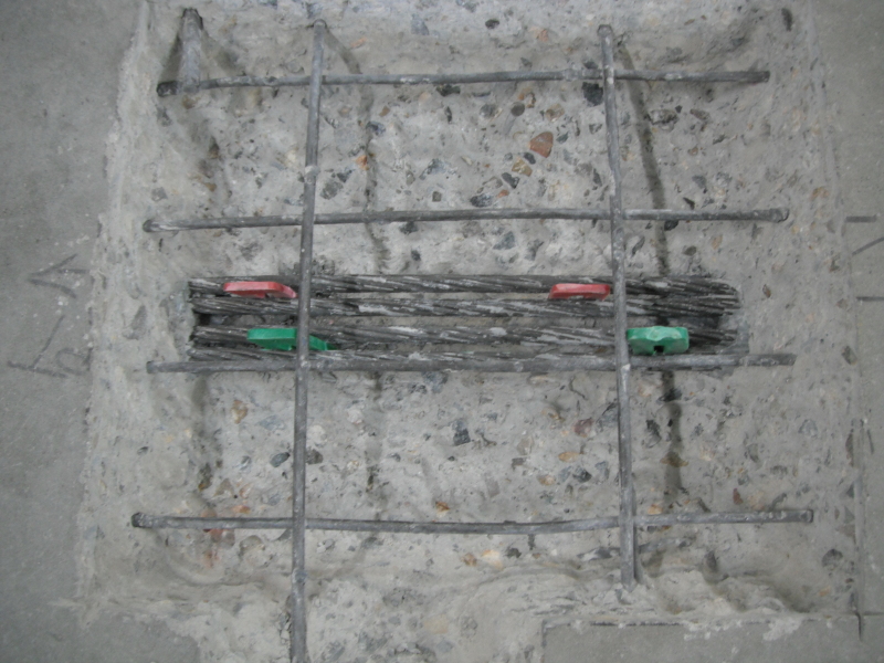

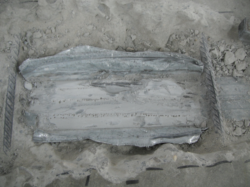

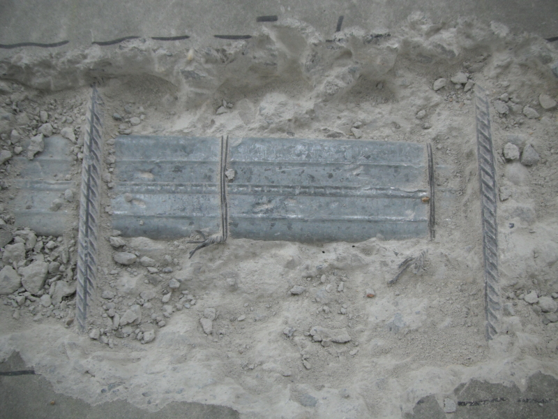

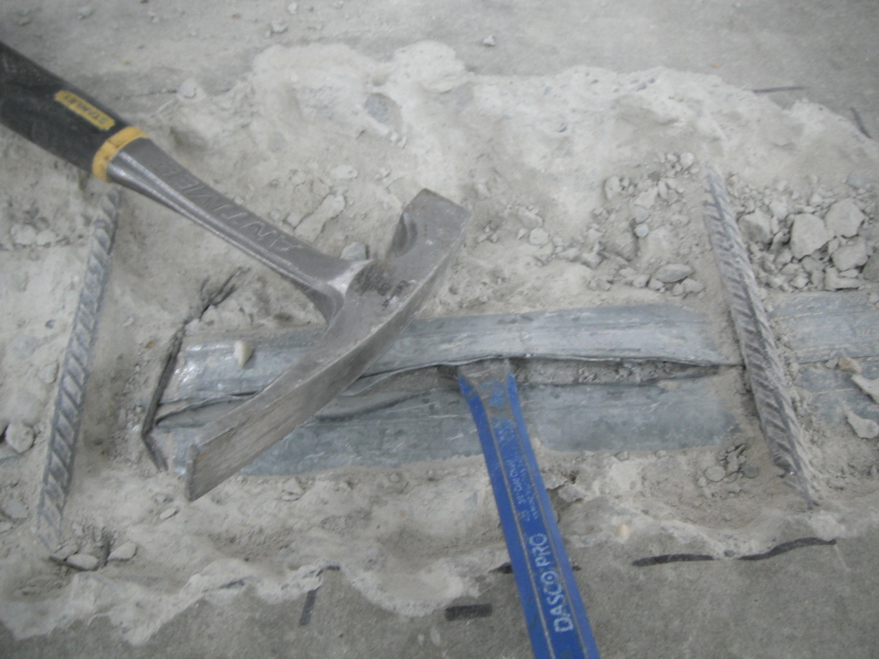

Structural consultants have there own particular details on how they terminate grouted tendons, however most take the following form:
Some photographs of a typical tendon 'epoxy anchor' prep work (prior to epoxy placement and strand cutting):
Also, it is a good idea to use dry course aggregate as both a void-filler and heat-sink when dealing with depths of epoxy resin that are more than 50mm. When using aggregates, use an epoxy with a viscosity of approx 500 cps.

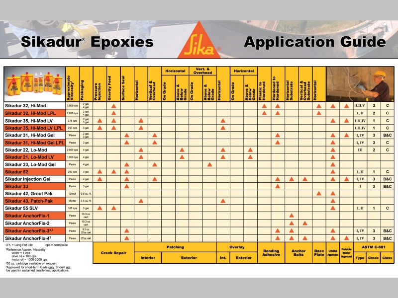

Would Sikadur 42 be an appropriate epoxy to use for the termination?
RE: Code or Standard or Reference for cutting of PT tendons
Seems to have perfect properties for the application, and the data sheet does state that it is suitable for horizontal surfaces up to 12" grouting depth, with low exothermic properties. However, this is a 3 component product and the 3rd component is dry aggregate so probably not the most cost effective product to use - paying for packaging and freight of aggregate that may be locally available for less cost.
Sikadur 35 (a low viscosity resin) so with user-supplied dry aggregate is probably a less expensive option.
Depending on your service temperature you may be able to use Sikadur 32, a gel-type resin with a viscosity of near 10x that of Sikadur 35, again with selected aggregate/s.
See Link for product use matrix, as follows:
