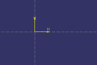

Hello Guys,
I need a help with a simple problem as far as i think.
I open a DXF file and copy the contents or 2D geometry from the drawing and paste it in the Model Sketch.
Doing so, everything is pasted but i can't really see it. When i exit the sketch, lines and points are there. But when I double click the sketch everything vanishes again.
Can someone tell me what's going on and how to fix it?

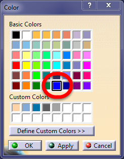

You can also: select all DXF geometry via cursor or tree and change graphic properties to a visible color.
or
change the color of the DXF in the drawing prior to bringing into the sketch.

Guys,
I have tried everything:
1. Changed the color
2. Fit all and look around
3. View in hidden background
4. Make sure nothing is hidden
5. Check if the sketch contains lines and points
6. Toggle between Blue and Orange sets
Nothing is working for me... anyways I really don't make any changes in the sketch, so it is not stopping my work but we need to come up with the solution.

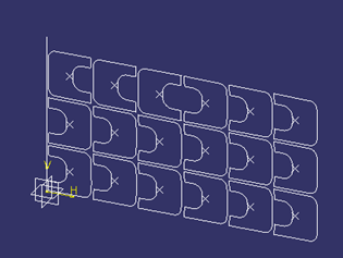

RE: I can't see anything in Sketch
I imported the DXF into a Drawing selected it all, then copied and pasted into a sketch.
No Problems.
See attached.

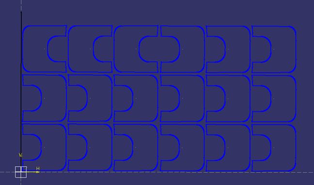

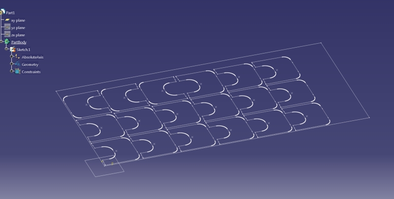

This is what I see in sketch:
outside sketch:
all but one line in the sketch are blue (0,0,255) : (guess I did not copy all dxf geometry, I m missing some frame black lines)
what color is you background?
all but this:
is on layer 0
do you have a filter applied?
chose all visible to remove all filter.
Also 15000 elements in sketch might be too much for some video card (who knows)
copy small area from DXF into sketch and see if you have same result or not
Eric N.

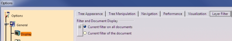

FYI
There is one setting on whether the filter is applied to all or current documents.
I have seen filters accidentally applied by opening Catia v4 models.
Once you open a V4 model, v5 will apply the filter that was saved in the V4 .model file.
Now every time you open a v5 file, this filter is applied until you turn it off or delete it.
