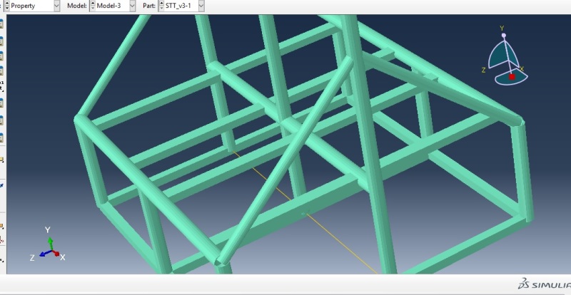

Hi guys,
I put all profiles and used the assign section, but when I try to render the entire model, two lines still stuck, like we can see in the image.
I imported this part from .IGES, put "beam" when created the section. Everything seems ok. I have another model and this problem don't happen.
Anyone knows how to fix it ?
Thanks in advance.

I could imagine two reasons - either a rendering problem or something is wrong with your data.
Run a datachek. If something is wrong with your data, you'll get an error.
If the datacheck runs fine, open the ODB in CAE/Viewer and try the rendering in the visualization module.

Solved the problem.
Just forgot to put the orientation vectors in this two lines.
