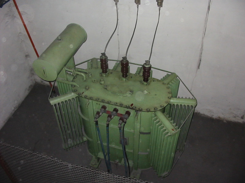

We have a 500 kVA 23kV/380V transformer at our plant
We don't do any maintenance to it at all
Can anyone guide me about what is the usual maintenance that has to be done to this type of transformer?

Your transformer looks well cared for.
Keep it that way and it should last a long time.
Track the moisture content in your insulating fluid. If it starts to climb, remediation (dehydration) is a good idea.

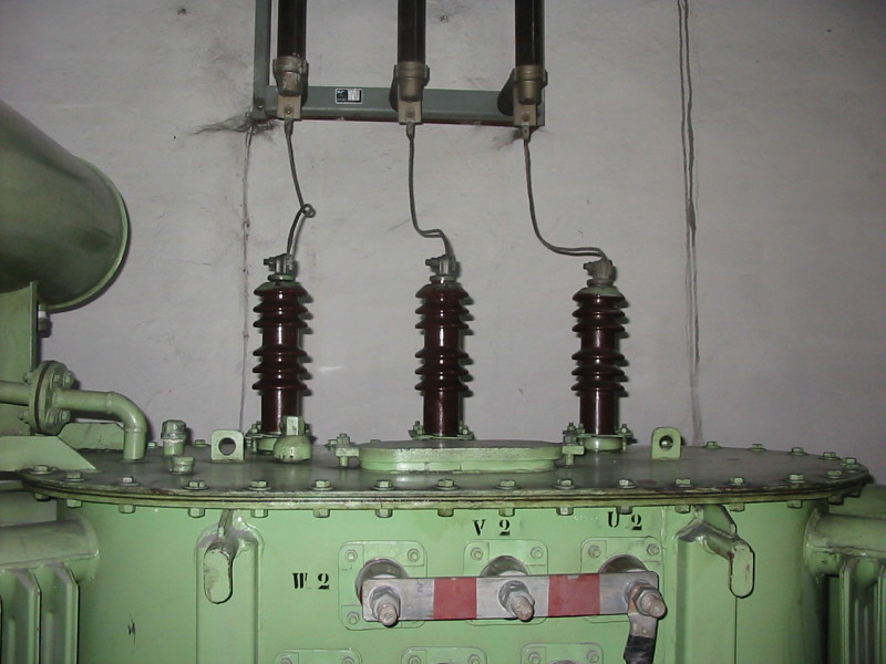

Oil samples (Quality and DGA) are not very expensive and there are many service companies that can perform this work. For maybe (US) $300-500 you can have the samples taken and analysed. Very inexpensive insurance and many facilities insurance providers require this. It looks like there is a sample valve below the LV connections. Depending on local safety rules and utilization of proper safety equipment, the sample could be taken on line.

I could not find a silica gel breather from the photograph. Normally there will be a drying gel breather connected to the air space of conservator. Most important part of maintenance is keeping the gel always in dry condition. Don't wait it to be saturated with moisture. Moisture is the silent killer of such transformers. Never allow an oil leak to persist. Moisture can get in through such leaks also.
Infrared temperature check of bushing connections - check once in an year. Oil test including DGA may be done once in 3-5 years.

The breather does not have silica gel. I think I could install a silica gel breather easily in the oil expansion tank
I will do oil analysis every 3 years and terminals temperature check every 3 months (we have the equipment to do it)
