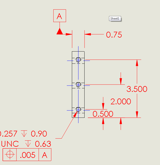

I would like to start integrating some GD&T tolerances into drawings, and I figured I would start with symmetry and true positioning
for features that I do often.
One concept I am trying to figure out is how to specify a hole should be centered within the width of a part.
Here the width is not a critical dimension, but whatever it ends up being I want the hole to be centered
with it within 5 thou of the center line.
So I mocked this up:
But from researching symmetry positioning, this doesn't seem like the proper use. What would be the right
way to specify what I wanted?

This is not the proper use of symmetry but the bigger issue is your desire to use symmetry at all. Unfortunately ASME's definition of symmetry is not what one would think. I can see the tendency to want to use symmetry when the intent is to keep things symmetrical but it's not as simple as that. What you want to use here is position. If you are taking on the task of updating prints then you really need to have access to the standard. Look on page 116 of the 2009 standard for an example of how to locate threaded holes and read the explanations.

Have you done any reading or had any training in GD&T? It sounds like we need to school you from scratch. I can inspect your part and interpret your symmetry specification. Having said that, I agree strongly with powerhound's comments. Symmetry is inappropriate for this application. You need to specify true position.
Let's take your symmetry specification seriously. Your dimension specification to the holes, .375", should be boxed, making it a basic dimension. This makes it an exact, nominal specification. Symmetry means that this actual dimension is your real thickness divided by two. If you allow ±.25" variation of the thickness, then your hole will be at 0.50"/2=0.25".
Your holes actually must be positioned in two dimensions, which is accomplished by true position.

Reccomennd to use position instead of symmetry... the difference is symmetry is a relationship of centerplanes where what your really wanting to do here is position the holes about the center of the part, so use position.
Put the datum A attached (inline) with the .750 width dimension, make the .375 basic, remove the symmetry GDT and put a positon GDT on the hole size. This makes the datum A the centerplane of the width regardless of its produced size (it will always be the center) and uses position to locate the holes to the centerplane (within whatever positional tolerance you provide).

If you wanted it on center, couldn't you do what Koda94 said, but leave off the .375 basic dimension and add a vertical center line going through the holes? By definition this center line would be center of datum A (.75 width) regardless of actual size of .75 width.

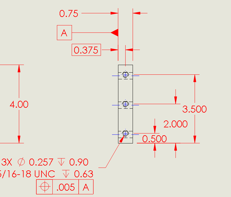

@Koda94 Like so?
I think I might have misunderstood inline with .75, because from this it looks like everything is still dimensioned from the left side.

If you want to have the holes centered your latest sketch doesn't achieve that.
Korda's advice is slightly off, TWJR input when taking in coordination with the correct part of what Korda says and looking at the image TWJR posted should work.
Like up the datum A indicater with .75 as Korda says.
This makes the center plane of the .75 dimension the datum.
To position the holes on this datum plane as TWJR suggests a center line should make it clear that the holes are nominally on the center line.
The position FCF is what gives the tolerance of how far away from the datum plane it can be.
Get rid of the .375 dimension.

As for putting inline, I was just reading page 56, figure 4-13.
Like so?

Look at how the B & C datum are located on the screen clip that TWJR attached. Doing this along with the centerline (and here is where I differ slightly from TWJR) that goes all the way through the part (not just through the holes) will indicate that regardless of what the 0.75 dimensions comes in at (be it 0.749, 0.72, or 0.whatever, the datum will be the exact middle of whatever dimension the part comes out to be.
I don't believe the basic 0.375 dimension is even needed, and is probably incorrect based on what you say (holes right down the middle) you are trying to achieve. But the 0.75 should be a basic dimension
You will also need a datum for the face the current view is sitting on and a datum along the face the 0.5, 2.0, & 3.5 dimension are taken from then the 0.5, 2.0 & 3.5 should be made basic dimensions. And you true position should be with respect to:
a) the surface the part is sitting on
b) the centerline of the 0.75 target dimension
c) the datum associated with the 0.5, 2.0, & 3.5 dimensions

yes, correct you dont need the .375 basic dimension.
Apex..., see attached example for correct placement of the datum A symbol. For it to represent the centerplane of the width of the part it must be placed in line with the dimension otherwise it only represents the surface.
As far as using additional datums (-B- and -C-) is determined by the design intent of the part. Based ONLY on the description in the OP it doesnt need the extra datums if all you want is to make certain the holes line up about the center of the width. For example if the mating part is using vertical slots to attach. But if the mating part is using holes its probably better to add B and C datums and make the vertical linear dimensions basic.
