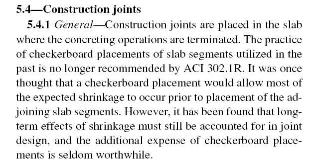

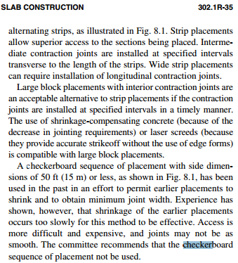

Quote (Ron)
That thinking comes from the old school thought that if you alternated placement of concrete in a checkerboard fashion with construction joints it would make the joints better
I presume that you're referring to these statement from ACI 224.3/302:
