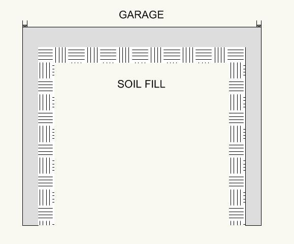

Forgive the poor drawing, but this is an 'artistic' section of what I'm proposing.
Any thoughts?

Where's the grade outside the retaining walls? How will you construct this? Do you have a soils engineer to help you?
RE: Upside Down Retaining Wall
The grade outside the retaining wall would be at the bottom of the stems. I would probably design temporary shoring confining the soil within, and pouring or shotcreting the face of the concrete walls. No input from the soils engineer yet.
You would need probably three levels intermediate concrete encased tie beams, the first at the bottom, intermediate and top, depending on the height of earth retained, all to keep the walls from spreading without external shoring. This can be done, but you are looking at hand tamping the fill. the two walls 90 degrees to this would be interesting...

Wouldn't it be easier to just put a structural floor in for the garage?

GeoPaveTraffic's solution would be mine. You can use the void under the garage for storage, and you don't have to bring in all that fill material.
Maybe construct it like a marine pier: set sheet pile (or equiv.) walls with tie backs between them, backfill and add more levels of tie rods. You could backfill with soil cement or lean concrete to keep lateral loads low. Angle the tie rods at the corners like at cofferdams.

A lot of the piers in San Diego are constructed using sheet pile walls with cross ties. The Edmonds Ferry Terminal up in Washington, too. The sheets are driven to depth to restrain the toe but your design would allow low level cross ties to hold the toes.
I've also seen MSE walls (mechanically stabilized earth?) similar to what you are doing and refer you to the manufacturers of these systems.
