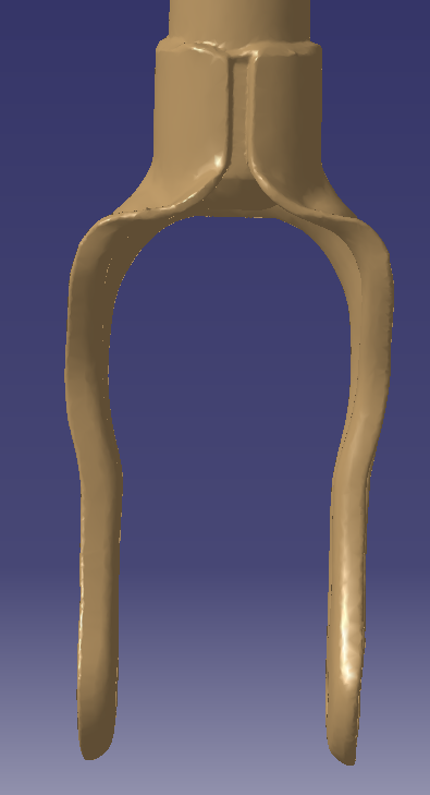

I need to design a Suspension Shock Fork (please, see the attached picture).
It doesn't seem to be a easy design, but I count on your advise.
Has somebody designed a similar part in the past?
How should I create this model?
Do you have a model by any chance?
CAD 2015

This looks rather morphed. Is it a scanned model ?
To me it seems one would use freeform modelling combined with sheet metal.
I'll give it a try.

RUGmechanic,
Thanks for reply.
Yes, it is a scanned model.
I have no idea about conversion of scan data to a CAD model so far.........

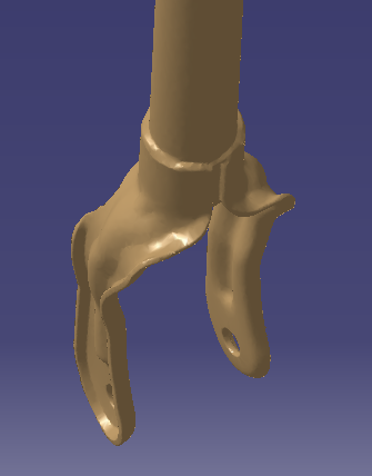

RE: SHOCK FORK design model
Could somebody show me how to design a part like the one shown in the two attached pictures?
Would the use of the Sheet Metal be possible in this case?
Mr. Baker,
Thanks again for taking the time to reply to my thread.
The area you started with wouldn't create any problem for designing.
The real problem is the area below the welding zone (please see the attached picture).
How would you design this critical area? Can you start a model ( the dimension do not matter) similar to the pictures?
Here's another part file addressing the other end of the model. It's a bit messy (I could have done a slightly better job using NX 10.0) but it gives you the shape that you're looking for.
JB,
Can you help me understand the swept feature? I'm looking at your example in 10.0.2.6. Swept(17) use the 2 sections and Bridge Curve(15) as the only guide, but Bridge Curve(14) has a direct influence on the shape of Swept(17). Can you explain what's going on or am I just missing something?
Thanks,
John
Bridge Curve (14) is guide 1 and Bridge Curve (15) is guide 2; each guide string is made of one curve. The "Select Curve (1)" prompt is showing how many curves make up the selected guide, not how many guides have been specified for the swept. You may need to expand the "List" panes to see the whole story.
If you edit the swept and highlight "Section1", you will see that it is made of 6 curve objects; "Section2" is made of two curve objects.
