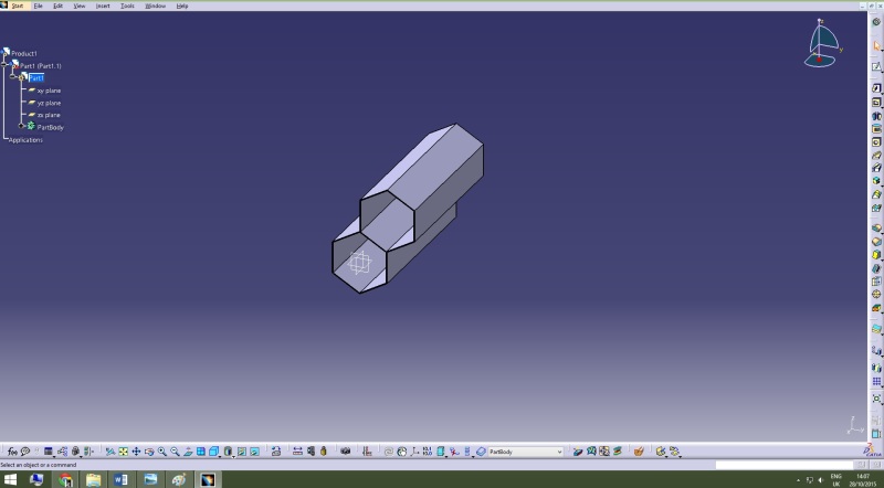

Could anyone help me or explain how to create Honeycomb structure in CATIA? I need to create a big honeycomb but always I can't go further than few rows. The best idea is to create one honeycomb and copy them but I totally do not know how to do that in CATIA v5, I tried mirror option etc but it does not work well. I attached photo how it should look like. If anyone has any idea please help me :) Thank you in advance!

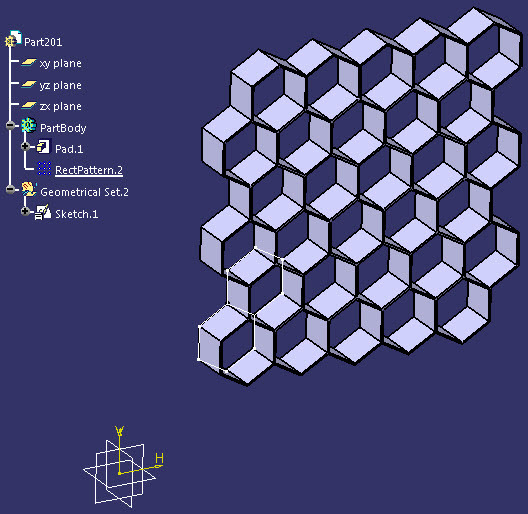

Use a "rectangular pattern" or "user pattern" found under Part Design workbench > Insert > Transformation features.

Looking closely at the lower-left corner, I see Drew sketched two hexagons for the first pad. He was able to make a Rectangular Pattern in the Horizontal and Vertical directions. That's pretty clever!
To get the same result, I would have made a single hexagon sketch, and patterned it in the Horizontal and 60° directions to get the bottom two rows, and then add a second pattern to go vertical for the other rows.

Thank you guys for you help but I still can't do that. I posted few pictures step-by-step how I am doing this and when I have a problem but someone deleted this and change my post (Weird) and my password has been changed, I do not know what happened :O

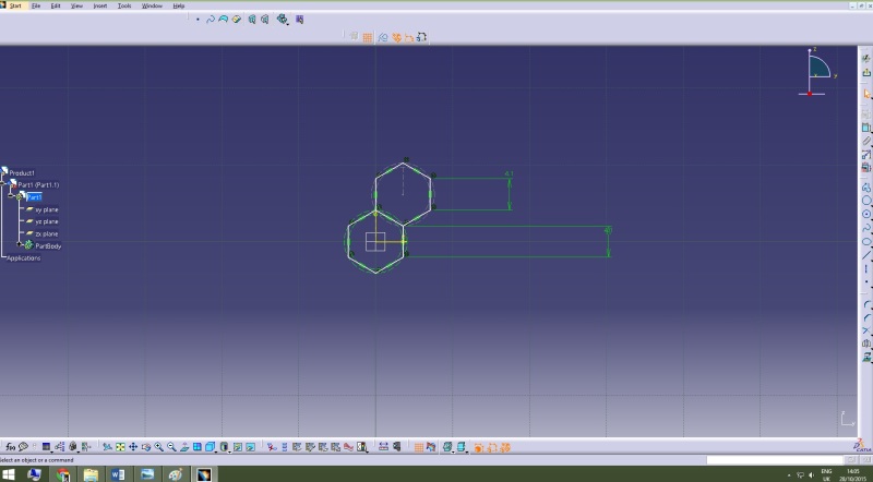

Thank you for your message. Yes I know that error is on my side. I posted how I am doing this step-by-step and the 4th step is my main problem, do not know how to do that equally and symmetrically like you guys did, if you have some time please have a look :)

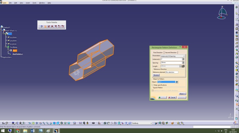

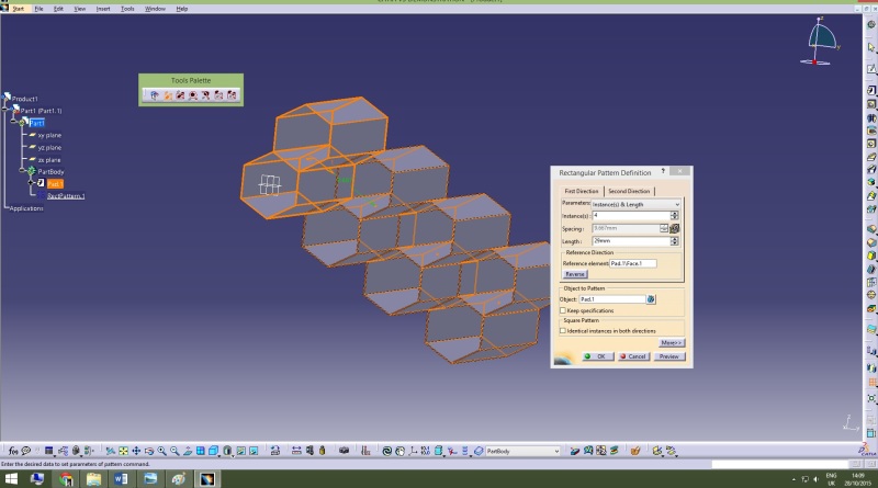

Thank you for your message. I did it with reference direction but is there any chance to leave all walls with the same thickness?

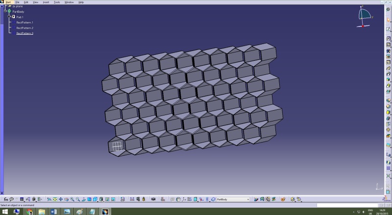

@drewmumaw Thank you but I did this. I mean, thickness when I am doing Rectangularn Pattern, is it possible to make "new honeycombs" stick to "old honeycombs" perfectly? With no gap or double-walls etc? :)

You can decide which side of the hex profile to have the pad feature create the thickness. The rest should just be a matter of calculating the math to make it work as desired.
