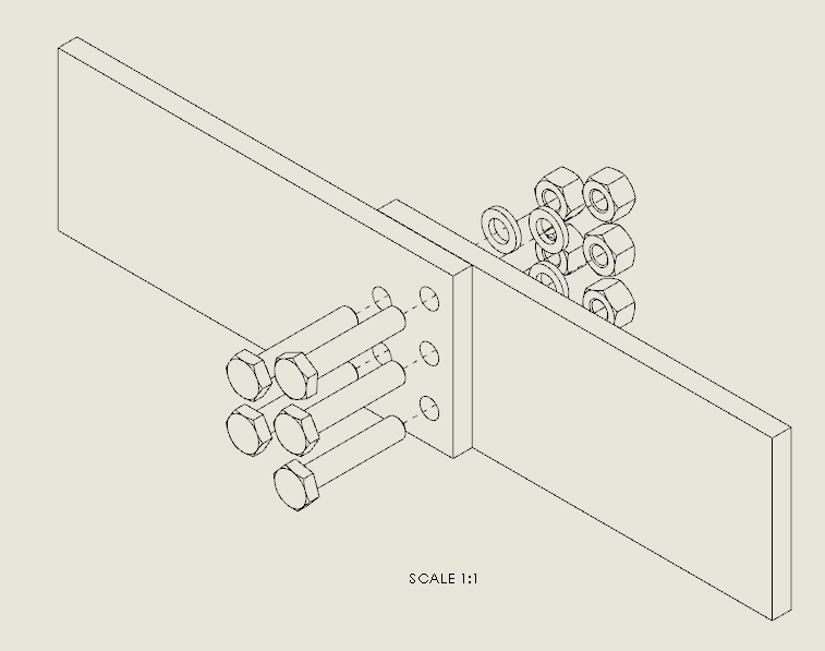

How do I calculate the UTS of a multi-row bolted lap joint like this?
Anything I find in PDF involves someone's thesis (a bit over my head) or only involves one bolt (not much help).
Can someone point me to something in the middle for the case shown?

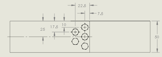

Thanks desertfox. That covers the basic issues but not how to allow for multiple rows of bolts/rivets. You see in my drawing that the two rows of bolts have different numbers of bolts and also they are staggered.
I have a feeling that that will complicate the issue, but it is a common occurrence in industry. I need to know how to make those allowances.
Cheers

You might want to dig out your old Strength of Materials or Machine Design text books, assuming you didn’t sell them used, for a six-pack. Good texts will have something on bolted connections. Also, any of the Structural, and specifically structural steel codes, will have info on bolted joints; spacing, edge distances, spacing btwn. rows, etc. And, they will also have info and methods for analyzing net sections around the various bolt patterns to determine the critical load path for a given bolt pattern. Right now, in your sketches and with their proportions, it looks like your bolt size, spacings and edge distances are much to tight for a practical joint. And, in a more detailed analysis of a bolted joint, you should give some thought to the fact that all the bolts don’t come into play at once. Some of them must be in bearing and starting to yield in bearing before others really come into play. There are also issues of how tightly you fix (tighten) the bolts.

Unless I'm missing something, all of your concerns should be addressed in the AISC specification (structural steel code): https://www.aisc.org/WorkArea/showcontent.aspx?id=...
You'll be most interested in sections J3 (related to bolt capacity, spacing, edge distances, etc), J4 (for capacity of connected elements, your plates) and B3 (which defines gross and net areas -- this will address your staggered holes concern). The commentary portion in the latter half of the document may also be useful.
Regarding dhengr's point about bolts coming into play at different times -- for a typical bolted connection with standard size holes (1/16" larger than nominal bolt diameter), we typically assume that structural grade steel bolts can yield and act in a ductile fashion until all the bolts in the connection are engaged -- regardless of the initial fit-up "scatter". Of course, if you have oversized holes (for example, in a foundation anchor bolt application), this assumption requires further consideration.

In an Australian context the equivalent design information is contained in the Australian Steel Code AS4100 in the connections chapter.
