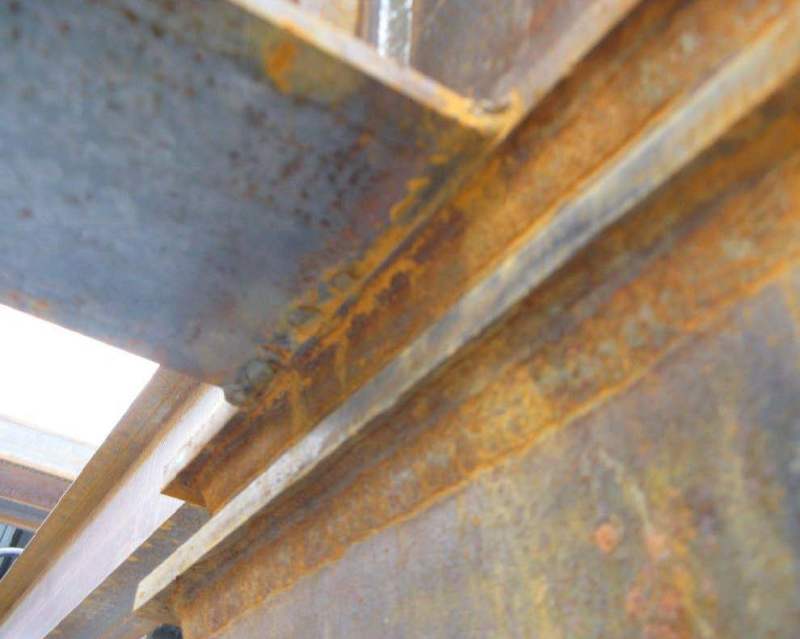

Pictures worth a thousand words:
This is a wide flange that is cut square and spliced.. we put cover plates on the web. But I told the contractor the main strength region of a wide flange is in the top flange and bottom flange..
Images showing the top and bottom portion of the wide flanged spliced welding at the web:
This is at the back of it. Is it considered full weld?
Whatever. I told them the flanges are the real meat of a wide flange where tension and compression can occur and told them to put metal plates on them too. What you make of this advice? Putting cover plates on the flanges would indeed make it sronger, wouldn't it.
RE: Welding Wide Flange Splices
First, you need to find a welder. Whoever made those snots on the beam can hardly be called a welder.

Agree with GTAW....those are some lousy welds. Also, from what you have shown, they are fillet welds on a cover plate that was maybe used as backing for a complete penetration weld. In any case...get a qualified welder.

The weld you show above is a very poor attempt at welding a complete penetration butt weld. There appears to be no joint preparation, no space between the two piece to be joined and poor technique in the welding. With this type of poor joint preparation, even a good weld would not penetrate the thickness of the web.
The fillet weld you asked about is on the cover plate on the opposite side. The welds are equally poor there.
The welding you've shown for this splice is dangerous.

Your welder is full of crap! The weld you showed is not the "back side".
As for the electrode, an E6011 electrode is a penetrating electrode that can be used in all positions. It is a versatile, "all purpose" electrode. It provided deeper penetration; however, it also yield greater porosity and slag inclusions that can lead to nondestructive testing rejection. The welder must know how to use this and other appropriate electodes for the application.

Xray on this crap will give no workable results, as the surface is too irregular. Nor will any other type of ndt, for the same reason. This should be done by a "coded" weldor, and with hi-quality, low-hydrogen rods. Google for farm code pdf, this fits right in.
By the way, pay nuts, get monkeys. $15 a day?
Agree with KingNero....radiography will fail this weld. It has improper profile, incomplete fusion, poor penetration and no doubt, slag inclusions. That would make it fail essentially any radiography criteria you apply to it.
Further, the fit-up is poor. The flanges are offset and warped.
Just because your welder has welded on high rise projects doesn't mean anything. He's obviously not very good at it and I would suspect any weld he has made on those high projects!

The initial photo you've posted seems to show no weld of the top flange whatsoever, unless my eyes are deceiving me. It looks like the welder merely butted the two pieces of wide flange together without any gap between them, and with no attempt to prepare the joint, and then deposited a very ugly partial penetration weld on the web only.
The top and bottom flange need to be full penetration welded for the member to have any meaningful strength!
It looks like the welder went back and simply dumped some weld metal on the top and bottom surfaces of the top and bottom flange where the pieces had been originally butted together without a gap between them. There was no attempt to grind a groove or bevel at that joint. That is not a full penetration weld! Regardless what type of electrode is used, you will only fuse the very top and bottom of the joint in each case, leaving a large gap of unwelded steel in the middle.
The welder is obviously untrained and unguided, and the situation is very dangerous. For each of these bad joints you are seeing, there are probably ten that you haven't noticed yet. Even if you fix the problem by reinforcing the splice joints from below, you need to do a thorough inspection of the rest of the work- every other weld this "welder" did.
There are primer paints that are intended to be "weld through". They are designed so that they do not leave a residue which is damaging to the deposited weld, though they can still generate some porosity or other flaws. They are just primers, and are not very durable- they provide little meaningful corrosion resistance beyond the erection period.
EPOXY is NOT a weld-through primer! If there is epoxy on pieces of steel, you MUST remove it by grinding for a sufficient distance on either side of the welded joint before you weld, or else you are very likely to generate flaws in the weld.

Quote:
The flux etc needs to be cleaned off for proper inspection.
Here is Lincoln Electric's basic video about visual weld inspection. It is aimed at Boy Scouts getting their welding merit badges.
https://www.youtube.com/watch?v=Ncguc7THEUY
I think the "welder" needs at least to spend a few days running beads flat and vertical and making pad welds on 10 mm material to achieve at least basic proficiency. Even then, I don't think he should be allowed to work on your job again.
I think the "expert welder" is going have to do a LOT of grinding or arc gouging to fix those welds. And probably cut out and replace some sections entirely.
Pages 32 thru 33 here discuss a minor case of one of the obvious deficiencies of those welds you are having to deal with.
http://supplier.huntingtoningalls.com/sourcing/doc...
Note the corrective action of cleaning the weld area.
The lack of cleanliness is NOT causing most of the problems however.
I envision the beam welding requiring be done in 3 different positions. Flat, vertical, and even overhead.
Here is a video showing some very good "vertical up" welding in process, and proper surface and edge preparation for 3/8"/~10 mm plate. Full penetration welds generally require some beveling or other edge preparation and multiple passes. They are NOT done by blasting thru the material in one pass.
https://www.youtube.com/watch?v=1QxT7JUjs94
Overlook the extremely uniform weld surface appearance. There is some leeway there.
Can you see how the weld completely fills the space between the plates, and fuses completely with each plate?
here is another series, from Lincoln electric. OK, but they spend too much time recording far away.
https://www.youtube.com/watch?v=oCS9t2CB6Vg
They are all using 7018 electrodes. As I recall the flux removal is much easier than 6011.
But notice the uniform bead, slightly convex, fusing with each side of
There are others here much more knowledgeable in structural welding than I am, so take their advice first- but seeing the pictures you've posted has me worried- you need to take care of this!
With two pieces of 10 mm thick steel butted tightly together without any additional field preparation, there is no way you can deposit a reliable full penetration weld. If you want metal from the welding electrode to flow into the joint, you need space for it to flow into- otherwise, you are trying to use a stick welder to do an "autogenous weld" (where the parent metal of both pieces is melted together and fused)- that just plain doesn't work. Just because you see "burn through" at the other side of the joint, does not mean you have deposited a sound, full penetration weld at every point in that seam.
It is my opinion that the right preparation for this weld would be to bevel both pieces on an angle with a grinder from the outside, leaving a vee shaped groove all the way along the joint, leaving a small root gap between the two pieces at the point where the edges meet. The other option would be to try to do a partial penetration weld from both sides, grinding out the root of the 2nd weld after the 1st is completed to get a clean surface on which to carry out the 2nd weld. However, to be sure you did this properly, you would still need to do sufficient grinding so that you ensured you got a full penetration weld at the point you can only reach from the outside, i.e. the point where the web joins the flange. The vee groove and completion of the weld entirely from one side is just easier.
If the welder is worried about burning through at the root, leaving a mess, then a backer strip can be used. However, the presence of the backer strip makes it difficult to inspect the root of the weld. A good welder would not need one, but depositing the weld on the lower flange in place (i.e. welding 100% overhead)takes considerable skill and practice.
Any of these processes are beyond the skills of the person who attempted to weld this mess in the first place. You need a real welder, trained and qualified, to do joints like this.

Based on the welds in your photographs, whether you use E6010 or E7018 is a moot point, akin to comparing a 4 cylinder engine to an 8 cylinder engine when there is no gasoline to run either engine.
The shortage of qualified welders is a problem in all countries at this time. Go with bolted connections when there is a question of the availability of qualified welders.
If you still use welding as the option of choice, ensure the welders are qualified by making them pass a test before allowing them to weld on product.
Best regards - Al

The welds in your photographs are of questionable utility regardless. Grinding them flush with the surface of the flanges will not degrade the function of the welds. If anything, there may be some unexpected surprises waiting for you once the welds are ground flush.

Based on the photographs you provided, the existing weld should be removed entirely and replaced. The welder should not be expected to be an engineer, metallurgist, and welder. The welder may have the skills needed to deposit acceptable weld, but he will likely need direction as to what needs to be done to correct the existing connection.
The root opening will become larger with each successive repair if the entire weld is excavated as it should be. The welder can deposit weld to build up the groove face to reduce the size of the root opening. The welding should initiate on one member to build up the groove face first. Backing should be used to provide the welder with the best opportunity to make an acceptable weld. I would limit the maximum build up the thickness of the flange, 10 mm in your case.
However, looking at the welds in your photographs, it would be easier to remove the affected section and replace it with new a new section of WF.
Done properly, the weld should be as strong as the carbon steel that comprises the WF beam. The attached sketch depicts what I would consider to be a reasonable approach to correct the problems depicted in your photograph. In the long run, it will save time. It can be modified to be bolted if it is easier than finding a competent welder.
As for the welding machine in your photograph; it is fine if the welder uses E6011 because it appears the output is AC only. E6010 electrode is intended to be used with DCEP (direct current, electrode positive). If the welders attempted to use E6010 with AC output, it would explain some of the problems they experienced.

below are the welds that connect a 1.7mm C section with a 4mm angle bar done by the new welder (with over 10 yrs experience trained by the Philippines Welders Society affiliates). how do you tell if there is weld penetration (a few regions enough to take the load isn't it).. it may look ugly but if there is weld fusion.. it is enough to join the filler metal and base metals molecularly... (edit: done using 6013 stick with using SMAW (Shielded Metal Arc Welding which is the only one available locally)
I think you already know what our reaction to those welds are going to be. Without a grinder to grind off slag you're going to have impurities in the weld and get a weld that looks like that. On the bottom picture, the left side of the weld almost looks like a decent weld...Almost

The last weld shown in the above photos has the following visually rejectable issues...just from what I can see in the photo:
1. Improper profile
2. Lap (as in cold lap or lack of fusion)
3. Undercut
4. Porosity
5. Slag inclusions
I'm sure there are others as well....
