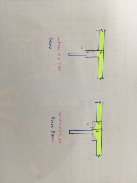

So are you now saying those are not band beams, but just strip lines of a flat plate?
RE: Eccentric moment
Quote (struggle66)
This is not a band beam so no effective depth and stiffness increased.
Why is it not a band beam? I thought that it was. What is a band beam? What is a slab band? Are they the same thing? I don't believe so, but perhaps others do.
BA
Curious. I've been assuming the following terms to be interchangeable:
1) Slab band (western Canada among other places).
2) Band beam
3) Continuous drop panel (Toronto weirdness).
I've been thinking that all three refer to the fundamentally two-way slab system in which drop panels are made continuous in one direction yet some aspects of design are one-way-ish.
KootK,
I define band beam in the same way you do, i.e. a wide flat beam thicker than the slab. Slab bands (according to my understanding) are not dropped; they are simply heavily reinforced areas within the slab. Post-tensioned flat plates are often reinforced with slab bands in one direction and uniformly spaced tendons in the other but the slab is of uniform thickness throughout.
If we are talking here about slab bands, then it makes no sense to talk about eccentricities because the band can simply be considered to be centered on every column, although not necessarily straight from end to end.
If we are talking about dropped band beams, then the eccentricity must be taken into account in the analysis because without some rather unusual formwork, the beams cannot be centered on every column.

Hi
BA
Thanks & sorry for my sketch. It looks like band.
What I meant is it is just beam (Not wide enough to be considered as band).I have this eccentric scenario in a few locations. And I just found out that at other locations they are wide enough to be considered as band beam (neither slab band nor extended drop pane).
Here is my understanding of band beam and beam. Rapt told me that before which I believe is logical.
