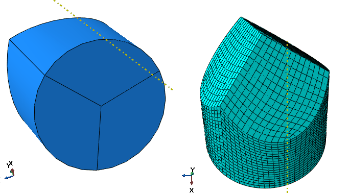

Here's a mesh that has fewer warnings about the element distortion that you might try. Firstly I removed the internal faces and then extruded the 3 lines at the top along a direction to partition the whole cell. The partitioned assembly can be meshed in hex or tet elements, but I can't see how you'd completely remove all warnings due to the overall geometry. If you use tet elements then use the higher order elements and not the C3D4 elements.

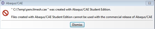

Hi corus, Can't open your file on my version of Abaqus. Can you please post step by step screenshots with description?

In the part module remove all the internal faces you created to leave just a solid block with no internal partitions. In the Assembly module or the Mesh module create a datum line using the point on the flat circular bottom, that extends upwards in the direction of the axis of the part. Then extrude each line on the top part of the pencil shape in the direction of that datum line. You can do this twice then for the final line it'll ask which cell to partition. Select that cell and extrude the final line down in the direction of the datum line. The part will now have structured regions which you can mesh. For some reason the mesh shown is distorted slightly and you need to go in and redefine the partition on all curved lines around the pencil top. Here's a picture of the mesh and partitions used.

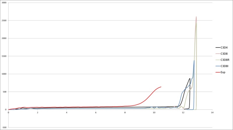

Hi corus,
I have tested my model with (all) C3D4, C3D8, C3D8R and C3D8I elements. See the below picture of load-displacement curve of the structure. The Red line is the experimental load-displacement curve, you can see that C3D4 (Tetra) and C3D8I (Hexa, incompatible) elements give better result but it is not good enough.
Can you please suggest how can I improve the result, especially the meshing? One thing to note is, there are elements with warning at the joints for all cases (for all Tetra and Hexa elements).

You don't use C3D4 elements at all. If they gave good agreement then it's probably just a coincidence. In general a coarse mesh, and C3D4 elements, are too stiff to give good results. Your results in general don't seem to match the experimental results for any element when you consider the initial slope of the experimental results. Try refining the mesh until you get a reasonable agreement between two models. If the results then don't match the experimental results then you'd need to consider the assumptions you made in the model. For instance, can the rigid part be considered to be infinitely stiff compared to the rest of the model? Are your material properties accurate? Are the experimental results accurate? (I've seen so-called real measurements be incorrect)
