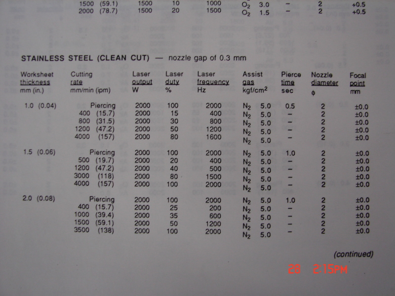

This was a tall order but I think I found something that should help plus I found some of my old notes from our 2415 Altair C2000.

Sorry it took so long to send these.

I managed to clean cut 6mm (0.236") Stainless steel 316L
If it interests you I can send you the cutting conditions tomorrow

With stainless I would use full frequency on the E4 and adjust the power if needed.

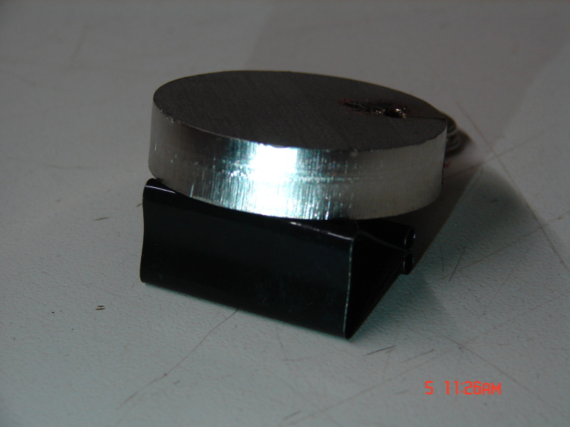

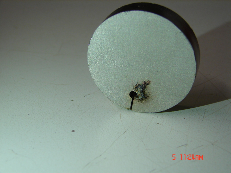

Send a picture of your pierce conditions.
M103B0.05 pierce
This is 3/8 stainless (.375)
RE: Help with cutting parameters
I never paid special attention to the pierce.
Always thought: if it goes all the way thru - its good enough.
I will take some pictures of my pierce (only tomorrow) but from what i remember its quiet with sparks going in all directions for about 3-4 sec.
Even if the pierce is good (or bad) why will it effect the whole part?
Parts i'm currently working on are very large, I only have 4-5 pierces in a sheet.
I do not know what M103 or M103B.05, where do I set this parameter?

I would like to see the pierce condition page and see if the settings are good. If it takes 3 to 4 seconds to pierce you might be using gas kind 1 and that could be where the oxygen is getting into the line. When you pierce stainless it should be full power and full duty with gas kind 4 and should be thru it in a second. As far as the pierce type I will post a picture soon and explain it.
Well, apparently my pierce conditions were wrong, and now with your parameters the pierce is much cleaner and faster.
Attached are the new pierce condition 103
And a sample cut with this pierce

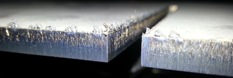

when cutting a circle, i get no burr, but when cutting straight lines i get burr on one side of the cut
Another annoying effect is black splatter under the sheet, which can be seen in the attached picture

The color of the cut and the dross tells me that oxygen is getting in the line. Try these changes so we can test the focus and see where it is if you have a small part you can use it will save on material.
1. Change the nozzle gap to .5
2. Change the focus to -4
3. Cut a part
4. Change the focus to -7
5. Cut a part
6. Compare the 2 so we have a better idea with the focus
With that edge color, your nitrogen gas is definitely contaminated. You may have received a bad batch of nitrogen. If you get the same results with your oxygen bottles closed and purged out, then contact your gas supplier to get a new 12-pack of nitrogen.

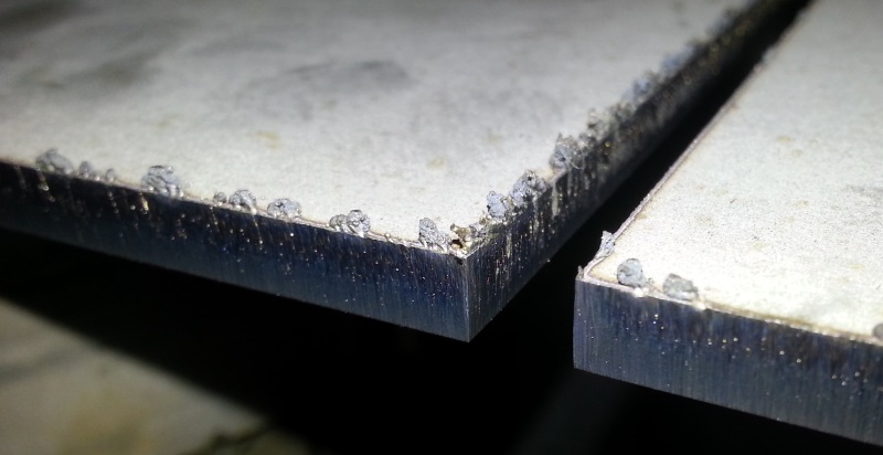

Our story starts yesterday when I spent 4 hours trying to get a clean cut on a 6mm stainless steel.
After 4 hours with no luck, I had to do something, I had to start cutting.
So, I did.
The cuts came out black with sharp burr and all dirty with splatter.
But at least I made the cut.
So today (friday) I went back to work, and tried to adjust the parameters to make the cut clean and shine.
Again I spent 3 hours in the morning with no luck.

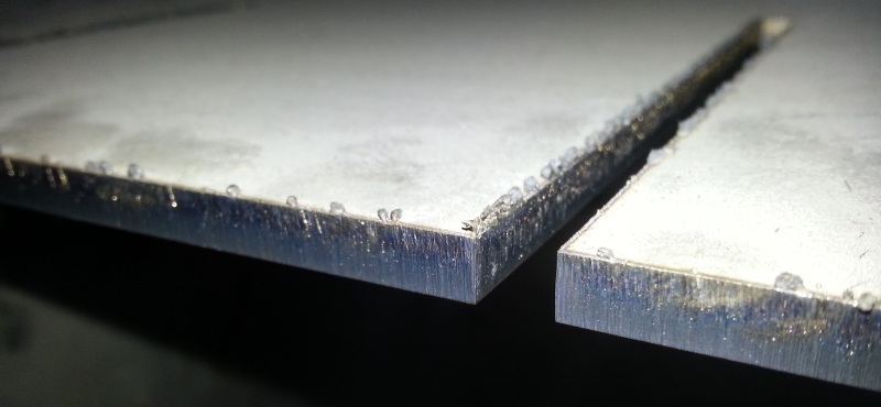

Afternoon I saw laserdog was asking about focus point, So I had back to work turned the machine ON and started cutting sample circles with different focus points. (at -8.5 the laser could not cut)
After the 3rd circle my nitrogen run out. just when I found that the best focus is going to be at -6.5.
I thought about closing everything and head back home to my family, but then decided to give it another try with the nitrogen cylinder from the dust collector.
How surprised was I when I changed nothing in the parameters but the cut came out beautiful.
Only then I realised that my nitrogen 12 pack are not as clean as they should have been.
I tried cutting rectangular and one side had a little black burr underneath.
I boost up the nitrogen pressure from 0.7 to 0.8 Mpa and the burr was gone.
Now that is what good nitrogen cuts like. Good job.
