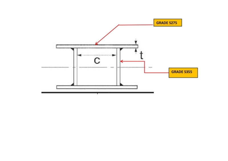

In Eurocode steel design code, is there any provision regarding the design of single member composed of different steel grades? I'm talking about a box section wherein top plate is grade S275 while that of side plate is grade S355 (see attached image).
Thanks in advance :)

That is a common fabrication for a box section beam, etc., so there must be provisions for that arrangement. But, I think you will find that you want the stronger steel in the flanges, not in the webs. What are the dimensions and thicknesses, and span length? How is it loaded? These things might dictate how it is welded and its assembly sequence.

Ok, the situation is this, we have installed a 40m (unsupported length) cross beam that will serve as a runway for gantry crane passing a tunnel. Since the beam (box type) is so critical for its purpose, they conducted a random test and found out that the steel grade used for side plate differs from that of top/bottom plate (as shown in the image).
Now, the entire set up is in question and the client want to see a structural design based on the actual material properties installed on site. Initial design uses S275 fyi. Is it using average yield stress, any idea?
This is actually the report overview;
Side Plate
Grade S460
Yield Stress (Lab results) 430Mpa
Top/Bot Plate
Grade S275
Yield Stress (Lab results) 235Mpa
*sorry for the image, S355 should be S460.
Thank you!

This should be referred back to the original designer, who I assume is up to date with Eurocode provisions. But if the whole thing was supposed to be of the lower grade, and for some reason, the higher grade was used for the webs, I doubt you have a problem. Both grades are common structural grades, and there should be nothing special about the welding requirements.

Initial design uses S275 for web and flanges and design was acceptable but the random material test results shows much lower yield stress value of 235Mpa only. Even if the material used in the web is of Grade S460 with test result of 430Mpa, still there is a lower yield stress present in the member which of course need to consider. I know structurally the member is safe (i think so), but the calculation is inconsistent with what is actually on site and that alone leaves a big question to the client.
Now that the setup was completely installed, the only way to lead the client into a close perspective of assurance is a structural design calculation based on the actual yield stresses. That leads to question, what stress do we need to consider for both flange and web? If using average stress, any research that explains how to use average yield stress? Any idea?

As I said, you need to go back to the design engineer. But you also need to go back to the steel supplier if the flange steel is weaker than specified. Where did the steel come from? There are pitfalls in using steel from the cheapest supplier, if that is what happened.

I disagree that a higher grade in a construction is generally fine if it was designed using lower grade values.
S355 and S460 require preheat and low hydrogen filler material when welding due to it's (much) higher carbon content than S235/S275.
They also have other fatique properties, although the difference is not that much.
Most likely the welds will not be done correctly and will need attention.
If this is a recent (after 2013) constructed design, the requirements of the EN1090 should also have been taken into account, meaning (amongst others) that material certificates of all used steel should be available. This might not be applicable depending on the countr(y)(ies) of fabrication and destiny.

You have to remember that the specified strength (S275) is generally the lower 5% characteristic strength, therefore getting 235MPa on a test coupon is very suspect as will be several standard deviations lower than the 5% characteristic stress, which is already several standard deviations lower than the mean. This is especially concerning if its the result of multiple tests.
If you were to do a sufficient number of tests the yield stress distribution should in theory follow the typical bell curve we all know and love, with 95% of results expected to be above the 275MPa grade designation.
However if you are getting 235MPa (average?) from tests then something is definitely up with the steel that has been used. Seems like fabricator has substituted or inadvertently used a lower grade.
Remember as well depending on the thickness of the plate, thinner plates generally have a yield stress greater than the specified grade designation (i.e. S275) due to the working/rolling process to get the plates that thin, and thicker plates a little lower than the grade designation. Least thats how it works in my part of the world in the steel standards plate is produced to (New Zealand/Australia).
You didn't mention what thicknesses you were using, but in New Zealand some of the thicker plates say 40-50mm thick at say grade 350 specification get down to a yield strength of 300MPa, whereas 10mm thick G300 plate has a yield strength of 310MPa for example. The effect is more prominent in our higher grades of steel > 350MPa. So check the relavent plate standards and see what the yield strenght should be.
