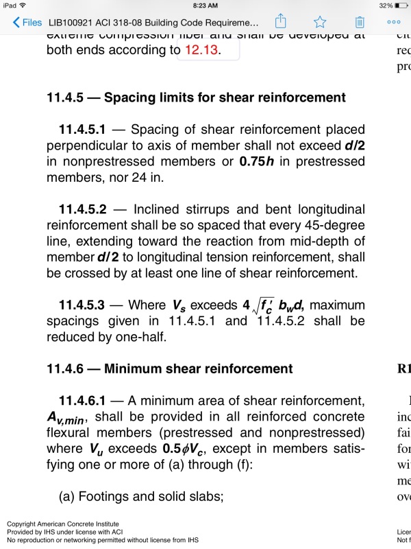

I thought clause 11.4.5.1 in ACI 318-08 covered this. 'Perpendicular to the axis', i.e. legs across the width of the member? If its was spacing along the member it would say parallel to the member. But maybe I'm reading it wrong as we have a similar worded clause in the NZ concrete code that makes the distinction between 'along' and 'across'. I could have sworn in later revisions of ACI 318 that they further clarified it, but I cannot find my PDF to compare.

Quote (agent66)
[I thought clause 11.4.5.1 in ACI 318-08 covered this. 'Perpendicular to the axis', i.e. legs across the width of the member? If its was spacing along the member it would say parallel to the member.
Here's the ACI clause for reference. It's taken to refer to longitudinal spacing but I can see how the wording leaves room for improvement.
