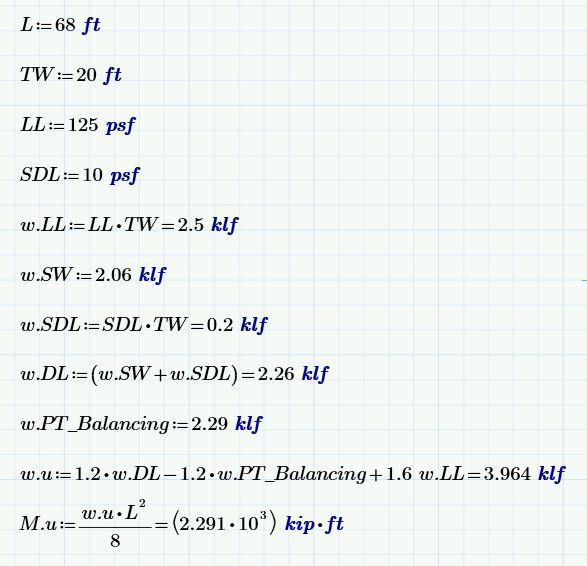

I have an existing structure I'm analyzing and I'm just not matching something. It's a parking deck, live load = 40 psf. Beam is 20" wide x 26" deep, pan joist system is 6" side x 18" deep with 4" slab (6" x 14" + 4" slab). The Beam span is 57' and the tributary width is 28'. The effective prestress force is 350 kips. At the center of the beam positive auxiliary rebar consists of 2#5 and 2#6 bars. At the support negative auxiliary rebar consists of 3#7 and 2#8 bars. I'm getting a capacity of 712 k-ft positive and 872 k-ft negative. I am getting a DEMAND of 630 k-ft positive and 1262 k-ft negative. This can't be right. I'm just checking the existing loads, I haven't put the proposed loads or anything on there. d=23.75". I'm not sure what I'm missing, I may be burnt out and missing something to simple that I may be booted from the forum but any help would be greatly appreciated.

Quote (jplay2519)
Are you assuming wL2/24 for M+ and wL2/12 for M-?
Doible check your effective prestress of 350 kips (or 14 x 1/2" dia tendons).
Assuming this is an internal span, with maximum drape (h = 21.5"), the equivalent balanced load is approx 1.54 klf [from P x h = wL2bal / 8 ]
Assuming a pan joist spacing of 30", your equivalent slab thickness is 6.8" over the trib width, so including the SW of the 26" x 20" beam the total applied SW is approx 2.75 klf.
Only load balancing 56% of SW which is low...so maybe recheck your Peff from the existing design or shop drawings.
Of course, if my assumption of the pan joist spacing of 30" is wrong, so too is my calculated balanced load smile

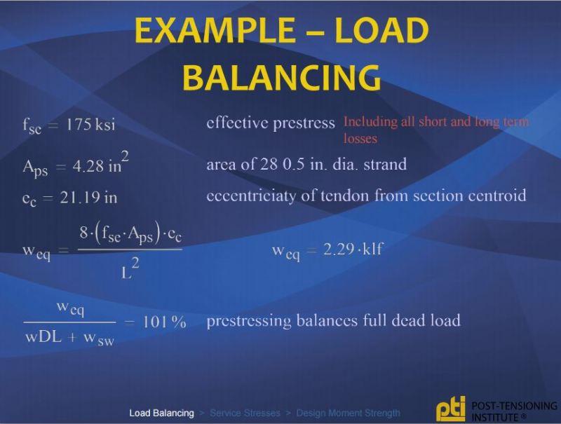

All I really stated initially is that PT drape helps resists load and should be accounted for in some fashion, which is obvious. Otherwise, we wouldn't have the Golden Gate Bridge to admire. Whether you view the effect as an externally applied balancing load, or a boost to ultimate member capacity, is immaterial and simply a matter of choice.
RE: Existing Post tension beam doesn't meet what the existing loads would require

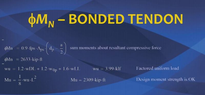

It seems in the PTI presentation that they still use all of the load for Mu (dead plus live) when the dead load was shown to be balanced out (page 43). The capacity of the beam is checked against this number, so I don't see how the balancing helped out in capacity or demand in that example. I understand the concept of incorporating the drape and it makes sense, I remember discussing in advanced concrete a little bit. I'm not sure how to actively use it though, because even if I update the stresses the Mn vs Mu is still way out of wack.
Can you direct me to that example/publication jplay? It would be great to have a common basis for discussion.
Oh I'm referencing the link you sent earlier. Link. The section 3 of a series it seems.

Quote (jplay)
Not so fast. I believe that w_0p represents the effective balancing load and would in fact be negative. I've KootK-ized the example below to show how PT drape effects the bottom line when it comes to bending capacity/demand. I think that you'll get the idea.

jplay2519,
Now that we have all 'hijacked' your thread...here is some on-topic info:
1. With the pan joist spacing of 6' c/c, the prestress is balancing about 70% of DL to interior spans, but less in end spans.
2. Based upon a quick check I ran, you require significant more flexural reinf, as you indicated. Calcs based up 14x0.5" UNbonded strands, or 350 kips.
3. There are ductility problems in negative moments regions adjacent to interior columns, requiring compression reinf.
4. Long-term delfections are up there.
Thanks @Ingenuity. I thought I was going crazy. I don't see how you could so under reinforce this AND get it though permitting. I need to pick up a software package to be able to get into these calcs because the hand calcs are nice but I think clients are going to take issue if they ever get a peer review with Post tension hand checks. Does anybody do demos of their PT software? I only ever see people selling.

Kootk,
Just trying to make sure I understand what you are suggesting, so I will go through what I think your steps are
If we assume a single determinate span of length L and a rectangular section of depth D with the prestress force P anchored at mid depth. And then the tendon drapes down by the amount e parabolically to midspan from each end.
Assume the compression centroid depth at ultimate is dc and prestress force increases by deltaP at ultimate to be P + deltaP.
We will forget about capacity factors etc at this stage, assume they are 1 for ease of calculation.
balanced load = wp = 8 P e / L^2
1 Calacuate capacity at end of span at the anchorage
M*anch = (P + deltaP) * (D/2 - dc) (basically Tension force * lever arm)
2 Calculate capacity at midspan
M*midspan = M*anch + wp l^2 / 8
Is this what you are suggesting?
Quote (ingenuity)
It is not just me stating this
I know. Similar statements pervade the literature. It wasn't my intention to single yours out.
KootK,
What is the source of this reference that you quote above:
@Ingenuity: it was taken from one of those VSL manuals that I linked above. The slabs one I think. In light of my work and some of rapt's comments, I now take that to mean that one could calculate ultimate capacity using balancing loads but it would be a computational nightmare as a result of the influence of hyperstatic effects etc.
Google tells me that it was from the first of the four VSL papers KootK linked above :)
Surprisingly, an exact search on Google finds a couple of other (possibly dodgy) sites with that paper, but not the VSL site.

A bit late perhaps, but I think there are a few points based on the "Golden Gate Bridge" analogy that are worth making:
Taking KootK's section B version of the GGBA:
Let's make it even closer to an unbonded p-t beam by moving the cables down at the ends so they intersect at the concrete centroid, then anchor the cables to the concrete with a loss-free anchoring system. The forces in the cable are now the same, and the concrete is the same except it now has a uniform compressive stress.
Compare this with a beam with the same layout except it has horizontal bonded prestress with an Infinite Debonding System (patent applied for) so that at any section the stress in the concrete under dead load is exactly uniform.
At mid-span the stresses will be exactly the same in both systems. This applies to both the concrete and the cables.
As we move away from mid-span:
  1. The force in the cables in the horizontal bonded system progressively reduces, so that the compressive stress in the concrete also reduces, but remains uniform.
  2. The shear forces are carried entirely through the cable in the unbonded system (as the vertical component of the cable force), and entirely through the concrete in the bonded system.
If we now apply an increasing uniform load until the maximum compressive strain in the concrete at mid-span reaches 0.003 (or whatever our ultimate limit strain is):
  1. In the unbonded system the force in the cable will remain approximately unchanged (assuming sections at the end rotate about the concrete centroid, and ignoring the effect of increased sag), but at mid span there will be an increased moment due to the non-uniform concrete stress.
  2. In the bonded system the cable force will increase to yield, so the force in the concrete and the nett moment will both be higher than for the unbonded system.
  3. In both systems all the additional shear forces will pass through the concrete.
For the unbonded system we could calculate the ultimate moment as the sum of the balanced moment plus the additional moment in the concrete, but it is simpler just to work on the basis of force and moment equilibrium, as we would for the bonded system.
Sometimes I wonder if it appears as though I'm trying to lay claim to something more radical than I actually am. In an effort to clarify, please see the sketches below where I have derived the ultimate moment capacity of a simple plan post-tensioned beam:
a) Using the traditional approach.
b) Using the balanced load effect.
The algebra comes out in the wash and, as expected, the results are the same. Did I make a bunch of simplifying assumptions? You bet. And if you feel that any of those simplifying assumptions invalidates the core work, feel free to jump up and down while waving your arms furiously.
Here is a list of what I believe the takeaways are and are not:
1) Once could calculate Mu using the balancing load effect rather than the traditional method.
2) I am NOT suggesting that this is a better way to calculate Mu. It's a worse way computationally.
3) If one removed the balancing load effect from the second formulation below, the ultimate moment capacity would obviously be reduced. Since methods one and two are statically equivalent, the same is true for method one. Thus, balancing load effects play a role in ultimate moment capacity.
4) In the usual formulation, we don't get to apply T at (e_anch + e_sag) from C because that's where the tendon is. We get to apply T there because that's the location that the balancing load effect has shifted the center of precompresson to. It's just math/physics fun that the center of precompression is always located at the tendon height. I derived this aspect of things with details A&B above.
That's it. That's the entirety of my argument here.
Kootk,
I was not going to respond again on this topic, but after reading your 4 points above, I think it is necessary
Answering your 4 points above
1 Yes, the calculations will work this way if
- the stress in the tendon at ultimate is the working stress - it is not
- the stress in the tendon is constant along it full length - it is not though it is sometimes assumed to be by lazy designers and lazy software developers
- the member is determinate
- the tendons are anchored at the centroid of the section at the ends
- the member is prismatic (there are no changes in section along its length)
- there are no reversal load situations
- the tendon has a single profile shape (no reverse curves etc)
- if you are only interested in an Ultimate capacity and nothing else (ductility, curvature etc) stresses and strains in other reinforcing in the section, compression reinforcement effects and anything else to do with section design. You cannot even determine the strength reduction factor for some design codes because it is related to strains and curvature (ACI and AS codes).
- probably a few others I have not thought of
2 see 1!
3 See 4!
4 The centroid of the tension force is not determined by the balanced load. T is at the centre of the tendon force which is at the centre of the tendon. The "equivalent balanced load effect" is caused by the drape in the tendon from the anchorage to its low point. Not the reverse.
Load Balancing is a calculation tool and that is all it is!

OK, so we are now purely discussing "Equivalent Balanced Load" effects, under the prestress force at the time of stressing. Not due to any other forces induced in the tendon due to applied loads causing member curvature and increases in tendon force! And not looking at section capacity or member capacities.
The tendons in the 2 diagrams below will result in the same equivalent balanced load effects, though one has a perfectly straight tendon and one has a harped tendon!
That is because the equivalent load is NOT simply caused by the change in slope of the tendon. It is caused by the change of slope of the tendon relative to the centroidal axis of the concrete. In the first diagram, the centroidal axis is constant and the tendon eccentricity changes. In the second diagram, the tendon is perfectly straight with no angle changes, but the concrete centroidal axis changes slope. Assuming the relative slopes between the tendon and the concrete are the same in both cases and the prestressing force is the same, both will result in exactly the same Mp diagram and exactly the same Equivalent uplift force at midspan.
Its effect is a moment diagram equal to P.e at any location along the tendon. For nice simple tendon profile eccentricities from the concrete centroid where the profile eccentricity matches the BM diagram of a load type, this can be represented by an "Equivalent Balanced Load". All this Equivalent Balanced Load does for you is give you an easy way to calculate P.e at each point. Yes, it creates stresses that negate the effect of an equal and opposite applied load to the structure, simply leaving you with an axial compression stress condition under that loading, but that is because the P.e created = -Mapp.
But the concept of Equivalent balanced Load" does not extend beyond that. It is an easy way to visualise the Pe effect of the tendon relative to loads, or to calculate a tendon profile to match a load condition.
The 3rd diagram takes this one step further with a harped tendon in a cranked beam. The stress condition in this beam is pure axial compression. There is no eccentricity even though the tendon profile is Harped. The centroid is also, so they negate each other.
This logic is described in good PT books. Possibly no modern books, but the real ones e.g. Guyon's Limit State Design of Prestressed Concrete, Leonhardt's Prestressed Concrete Design and Construction, TY Lin's Prestressed Concrete plus many others including some modern ones. Also a lot of courses on PT will cover it.
While I disagree with your conclusion here, know that I found your three examples very enlightening. I'll tackle them one at a time.
#3) This is an extremely salient example for demonstrating the internally equilibrated system that forms between the tendon and the concrete. The tendon does create a balancing load effect but that effect is perfectly offset by the P-delta action of the anchorage forces.
#1) I now see that this example is virtually identical to #3 in all of the ways that matter with respect to the balancing load effect. It could essentially be thought of as example #3 with some extra concrete thrown in. The balanced load effect is the same as it is for #3. The P-delta action of the anchorage forces is the same as it is for #3.
#2 This one caused me some heart palpitations for a while. That was until I realized that this one is not an example of balancing load effects. I feel that it fails to meet the fundamental criteria necessary to qualify as balancing load effect:
a) The effect is not generated by tendon curvature.
b) Forces transverse to the member's longitudinal axis are not generated.
c) Load is not "deposited" by the tendons at the supports.
Scenario two is no more an example of balanced load effects than is the beam shown below. In both instances, anchorage force eccentricity results in upwards curvature. However, in neither case is that exemplary of the load balancing effect phenomenon.
Quote (rapt)
Based on the examination presented above, I am still not convinced of this. I previously proved that balancing loads could be used to calculate ultimate capacities for the very simple case of a simply supported member. My strong suspicion is that, with appropriate modification to the technique, balancing loads could be used to determine the ultimate capacity of a system of any complexity.

1 Unbonded prestress does increase in stress under ultimate conditions. If you understood anything about PT design you would understand that. Under curvature of the member, the tendon elongates thus increasing the tension in the tendon. It is just not related to the concrete strain at any point in the member, it is related to the overall member length change at the depth of the tendon. That is why I had to qualify it.
2 1 above does not have any Pdelta effect as you call it. How can it be the same as for 3.
3 Balanced load effect is just one way of calculating Pe. Both 1 and 2 have the same Pe. They both generate the same Equivalent Balanced Load. Balanced load is related to the eccentricity of the tendon from the concrete centroid. Not just the tendon curvature. The tendon in 2 does have a change in curvature relative to the concrete centroid. It produces an Equivalent Balanced Load, exactly the same as the Equivalent balanced Load in 1.
4 You cannot predict ultimate capacity using balanced loads!

Quote (rapt)
Except that I already did. Algebraically no less. See my derivation, repeated below (third batch of sketches). As yet, no one's refuted it in any way.

Regarding the force in the draped tendon when the load was increased from the balance load to the ultimate load, I suggested that in the debonded case the force would remain constant, on the basis that it was anchored at the concrete centroid. In fact the cable will pass entirely through zones where the concrete strain due to the increased load is tensile, so there will be increased tensile strain in the tendon, especially after cracking of the concrete, but this strain will be distributed uniformly along the tendon, so the increase in strain at mid-span will be much less than for the bonded case. (Also there will be some position of the anchorages, above the neutral axis, where there will be no increase in length of the cable due to the increased load).
Regarding calculation of the ultimate moment including the load-balancing moment, I agree that you could add the load-balancing moment, and the moment about the concrete centroid due to concrete stresses and increase in tendon stresses. In effect you would be just subtracting the moment due to tendon eccentricity, then adding it back in again, as the balanced load moment.
