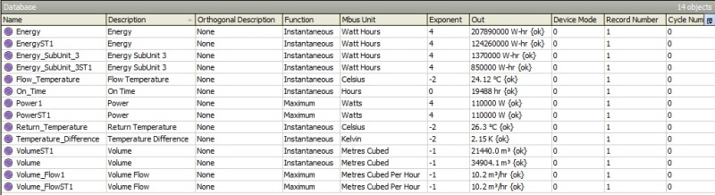

I am not sure if this is the correct forum to post this in. If it is in the wrong one my apologies.
I could do with some help with some calculations on a boiler. My area is more on the electrical and BMS side.
I have a project where I have the values of a number of points on an Mbus network and I need to visualise some of the results. The readings I have and there values at the time of writing this can be seen in the image.
I need to try and calculate the following;
Gas into the heat pump per hour
Heat out of the heat pump per hour
Heat Pump Efficiency per hour (Heat Out/Gas In)
Heat Pump Efficiency per day (Heat Out/Gas In)
Mean Ambient temperature per hour
Mean Ambient temperature per day
A correlation between the heat pump efficiency and the ambient temperature
If anybody could point me in the right direction I would be very grateful.

Second, a 'Boiler' is NOT a 'Heat Pump', you will need to confirm/clarify exactly what type of equipment you are looking at.
Third, you're going to need to get more information than what I see in the image you provided. Some sort of graphic showing where sensors are located relative to the device.
Without a graphic or better descriptions of what each point is, the table you provided is near useless.
Some things to keep in mind:
Gas usage is provide in one of 2 ways either by heat potential (W/Hr) or most frequently by volume(M3/Hr).
A watt (W) is a measure of energy as is heat.
If you want to find a correlation between efficiency and ambient temperature you will need to build a log of information over time. What you provide here would be just one point in this log. The more points you have the better your conclusions will be.
