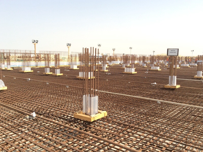

@hockie66.
Below is a pic to show you one being used so you can now say you have seen them being used.
I

Well, I'm not too old to learn, but your photo is a new one on me. I have only practiced in the US and Australia, so that limits my knowledge of how it is done in other parts of the world. While we are at it with my education, what are those tubes on top of the mat? Aids for screeding, perhaps? Another thing I have not seen.
RE: Wall and Column Kickers - Why (Pros and Cons)
The tubes around the column are just polythene in order to reduce the concrete slurrey (cleaning afterwards). You have to remove this before the concrete sets once the kicker is poured and finished. The steel tubes are to assist for screeding (simple straight scaffold tubes).

@Archie264.
the thread was about the pros and cons of using kickers, feel welcome to add if you have anything to contribute regarding that.
To me, and this may be a local or national exception, a diagonal brace is usually called either a diagonal brace, (strut or tie, (tension or compression members)), a kicker is something completely different. A kicker is a small concrete plinth set in place for the reasons mentioned above. Working abroad in many countries with many languages, myself a kicker is exactly that. I can appreciate you may have the term used for other things.
It seems that in this instance, even hockie66 learnt something new, which I am glad about, and why I felt the need to share. smile
If you take a look at the link in the above post you can see a finished kicker for a column.

Hokie66, you are correct. The tubes laid across the top mat are screeding rails. At least that is what I know them as.

Interactive Design Services
http://newtonexcelbach.wordpress.com/
I've seen kickers of sorts used in the states, but not for the reasons described above. The only time I've seen them used was for walls as part of tunnel form construction. Providing a little starter curb gives the tunnel forms something to run along. Easier to get the forms set that way. Have not seen this in conventionally formed structures.
MrHershey,
In tunnel construction, or any underground construction, you would generally have waterstops. The kickers provide for setting of the waterstops, and the slab reinforcement is not compromised.
'Tunnel form' construction, not tunnel construction. The structures I am referencing are above ground (though I suppose you may be able to use the system below ground as well).
Sample photo from Google images, not mine:
"Tunnel form", that's another term I was unaware of. A formwork system, and one aim seems to be to cast the walls and slab concurrently. That I don't want to happen on my jobs.
I'll bite. Why would you not want to do that on your jobs?
They actually make structures work a lot easier on the design side because you're forced by the tunnel system to have walls at a maximum of about 15' on center. Slab deflection is practically nothing with relatively little reinforcement for spans that small, wall stresses are extremely low because you've got so many of them. Can get by with relatively minimal reinforcement for low- and mid-rise buildings. Not sure what there is not to like from a structural standpoint.
Goes up extremely quickly as well.
I think I know why hokie66 doesn't want it on his jobs. Pouring walls and slabs together creates gaps in the walls due to concrete settlement while curing.
BA
When you cast the wall and slab together, the top of the wall is subject to plastic settlement cracking. The form supports the slab, while the concrete in the wall continues to settle a bit. Those plastic cracks can be closed by revibration, but when speed is the overriding principle, I would think the revibration may be overlooked. This is the reason you don't cast columns with the supported floor.
Understand what you're getting at, but this formwork system has been in use around the world for over thirty years now (Concrete Construction Article from 1982 on vibration of concrete in tunnel forms). To my knowledge, have never seen any issues reported with monolithic pours of walls/slabs in tunnel forms. Keep in mind the pour occurs at the exact same time, this isn't pour your walls in the morning and slabs in the afternoon. Usually the wall/slab mix is the same and poured during the same continuous pour. Proper consolidation is of course important as it is with any other job. Fortunately tunnel forms are rather specialized so the contractors who use them tend to know them well and know what they need to do to produce a quality building. All of our tunnel form jobs have been with the same contractor because they're the only ones in the area with the forms to do it. Speed is always a driving factor with every job. With tunnel forms what we've seen is the formwork provides the speed. There's not as much pressure on the contractors to skimp on the consolidation, inspection, and QC because they're already moving much quicker than normal with the forms.
But let's assume that we do get settlement cracks at the top of the wall, right underneath slab soffit. Would tend to think these would be horizontal cracks. Once you remove the formwork wouldn't the cracks close up on their own as the weight of the slab goes in to the wall? At that point would it really behave any different than the construction joint (really just an intentional crack) you'd get between slab and wall anyways?
Quote (BARetired)
@hokie: a few weeks ago, I read an excellent AU document on plastic settlement cracking that you referred me to. Based on my read of that document, the expected problem here would be slab cracking adjacent to the wall rather than gap formation at the slab/wall joint. Can you confirm that? Ditto for you BA if you have personal experience with this.
@MrHershy: with these buildings, what is the lateral system perpendicular to the tunnels?
Tunnels go in both direction. Just turn them 90 degrees and you've got shear walls in both directions.
Another example from Google image search, not mine:
KootK,
The plastic settlement cracking can be either horizontal at the top of the wall, or vertical in the slab adjacent to the wall, both due to continued settlement of the wall concrete after placement and vibrating, while the slab concrete remains supported on the forms. As in all plastic cracks, if you get to them quick enough, you can close them by revibration.
Mr.Hershey,
No, I wouldn't consider a horizontal crack which closes when the forms are removed to be the same as a normal construction joint, which closes in the plastic state of the slab. Pouring "the walls in the morning and slabs in the afternoon" is better practice, but I suppose that is not how this system is intended to be used.
KootK,
I have never witnessed the problem because I have never permitted slabs to be poured monolithically with walls or columns. Our code recognizes the problem by increasing required development length of horizontal reinforcement by 30% when it is placed such that more than 300mm (12") of fresh concrete is cast below the reinforcement.
BA
BA,
I think that requirement is generally for top steel in deeper beams, and is indeed another example of the adverse affects of plastic settlement. Another example is the reflective cracking over top bars in deep elements like spread footings with top steel.
