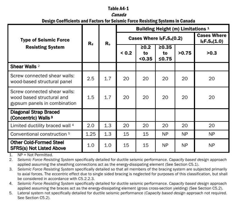

I've got a client who wants to build some 14 story buildings in a Canadian low seismic zone using light gauge shear walls as the sole lateral system (walls sheathed/strap braced). I interpret the table below as limiting the height of such a building to six to seven stories maximum. Is there an "out" someplace that would allow a 14 story building to be braced with CFM shear walls in Canada? I swear that I've seen buildings like this constructed taller than seven stories.
In my heart of hearts, I'm hoping that the table below will force the project to use concrete shear walls or conventional steel framing for the lateral system. That said, I need to vet that decision properly before taking it to my client. For comparison, note that US CFM braced non-seismic building heights are only limited by one's imagination and impulse to remain sane.

Have you done a number to see whether they can actually do the job?
RE: How tall can you go using CFM shear walls
I'm not sure Trenno. It's quite involved and I'm hoping to avoid the exercise altogether if it's a non-starter code wise. Conceptually, I've been shown a design for a 22 story version. Scary stuff.
Wow... Would be interesting to see what the details were. 10mm thick straps?!?
Yeah. The two annuli around the lifts and every partition as shear walls. And each partition comprised of two walls and four strapped panel faces. Drift seems problematic in the same way that it is with multi story wood shear walls.

After doing light gage for over 20 years,I would not touch that. The design and detailing is tricky and they never get built properly (at least in our area). Then you are trying to figure out how to fix their mistake after the fact. I have actually stopped doing load bearing light gage except for one story stuff. Keeps me sane.
I looked at an 8 story hotel being built here out of light gage. The amount and size of strapping they installed led me to believe it could not possibly have been cheaper to do it that way.

Certainly, I agree that it's a sketchy proposition. To some degree, however, we have a leg up on the quality control issue. Our client is a manufacturer of CFM wall panels and they're running some solid CNC-ish automated fabrication machinery. Tight tolerances and pre-drilled starter holes etc.
The quote below is from a CFM industry expert (academic). It is less than encouraging.
"I am not aware of any buildings that height being constructed with CFS shear walls, even if there is no seismic loading. We have never looked into anything this height under wind loading. As such, I cannot offer an opinion as to whether it is possible or not.
Regarding the AISI and other related US codes; this is more likely the case of a design along these lines was never considered in the past and this is why it is not covered in the design standards, rather than explicit permission that buildings of 14 storeys may be constructed with CFS shear walls. Best to check with the people in the US. "

steelframing .org says "did you know cfs can be used as the structural system for buildings as tall as 9 stories?". I'm guessing that they'd advertise at the upper limits of what's been done.
