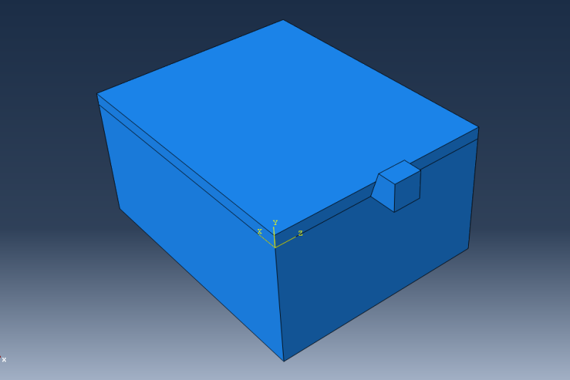

Below one can see my assembly:
I need my tool to follow a curve along the part.
The curve is defined by the sequence:
X=SQRT((Z^2)-20^2), using the correspondent datum axis as used in the assembly.
My boundary condition regarding the displacement value is seen below:
Meaning that by the end of the job, the tool needs to be at point (X,Z)=(20,0)

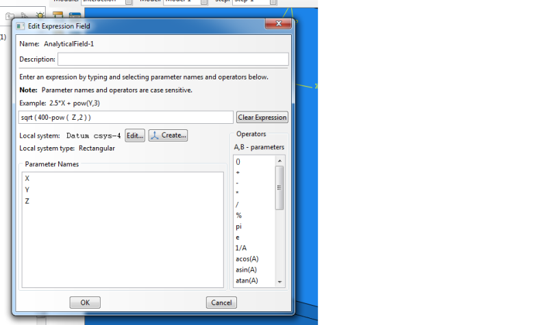

The expression I used is :
which is a mistake.

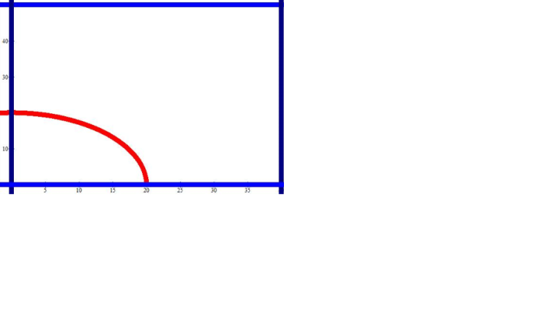

What I want to achieve is shown below:
Imagine that the red curve is the path I need my tool to follow along the part.
The red curve is the function X=SQRT(400-Z^2) with the axis used as in the assembly.
