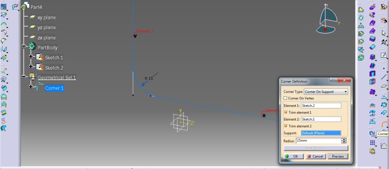

I defined a sketch plane by 2 lines, went into the sketcher, and I tried to put a radius between these 2 lines. Now I cannot pick them. When I hover over the lines, I get that pesky black circle with the minus sign in it. I tried the sketch analysis tool, and it is empty. Can anyone please suggest what I am screwing up?
Please see the attached picture.

you need to project the line in your sketch to use them in the sketch for geometry creation.

yes.the two lines are in a different sketch. u need to project them to be able to use them.all the best.

No, the 2 lines are not in the sketch. I used the 2 lines to create a plane (wireframe/plane/two lines.. pick line 1 and 2) Ok so I got a plane. Then I want to sketch on this plane. All I want to do is put a radius between these line. I also took your advice, and projected the 2 lines on the new plane before entering the sketcher, but i still cannot pick.

use project inside the sketch using sketch tools.also u can connect curves in GSD without any sketches. search for connect curve

GSD-generative shape design. in GSD use
in sketch use
then you will be able to use fillet
RE: Unable to pick
What does this mean? The bottom line is fine, the top/vertical is the non connex.
