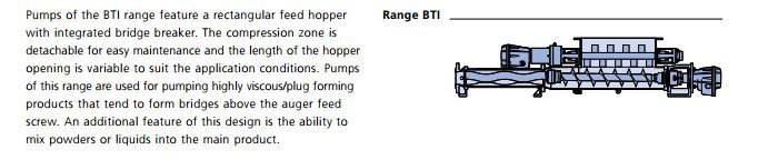

I attached some preliminary layouts. From belt press, it drops to a cavity pump equipped with a bridge-breaker. The breaker acts as mixer for the lime and sludge. The two sludge feed pipes will join to a common header leading to the bin.
It is live. See this product, we will be using it. www.saxlund.co.uk/products/sliding-frames.htm
I asked my colleagues, Seepex cavity pumps are already approved. Had we used conveyors, would you say they are generally cheaper or more expensive in terms of OPEX/CAPEX?

Thanks again guys! 'Oldest sludge gets discharge first', my engineering manager had similar reasoning, but project manager wanted to inject at bottom to save on piping/fittings. Sludge hauling is frequent anyway so I guess we are ok. Also what will happen if pump stops, then there is sludge inside the silo, say about 3m high, then restart the pump?
@bimr, we have mixer, sorry it is not clear in the drawings, but the cavity pump is equipped with a bridge breaker, this acts as a mixer. We only need to add another hopper between the belt-press and this rectangular hopper of pump.

I'd be concerned if the bridge breaker is enough for mixing. Look at this video:
https://www.youtube.com/watch?v=dr30WEVsX5I
What you see is sewage sludge at 20% (later 45% with added lime and wood shavings) TS pumped with a piston concrete pump. Note the action in the twin auger feeder of the pump early in the video. Confirm with Seepex that the bridge breaker is up to the task.
You'll also see that the pressure rises up to 20 bar on the stroke of the pump, at rather low flowrates. Since ths sludge in the video is 20%TS and you have 15%, I think you are still save. Viscosity (and non-Newtonian behaviour) seems to rise sharply (> linear) with TS content.
