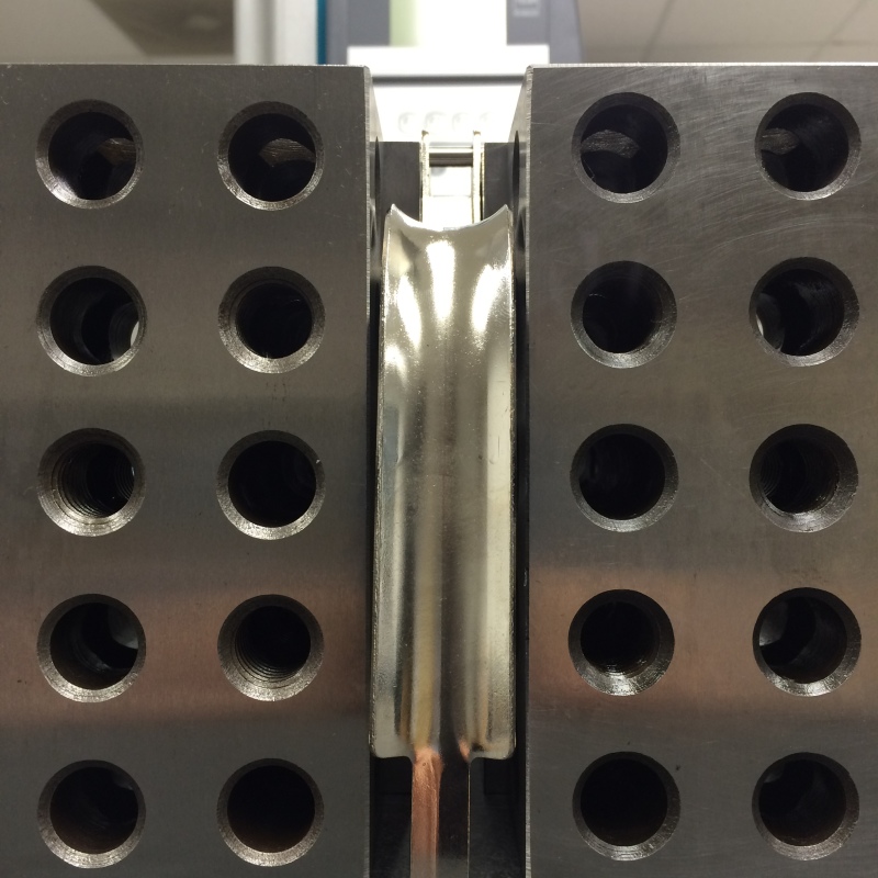

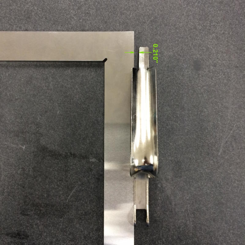

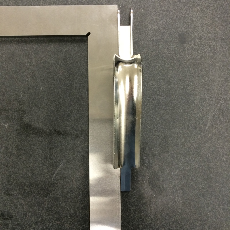

Additional information to my original post. I got these images from QC. Hopefully this helps understanding the problem we are facing with these parts.
In this image the trigger is supported by pin that is sitting on both blocks.
When aligning the trigger from this side, the gap is larger than what it supposed to be.
When aligning the trigger from the other side, there is no gap. That's what causing the rubbing against the frame (one of the support legs in the casting), when assembled.

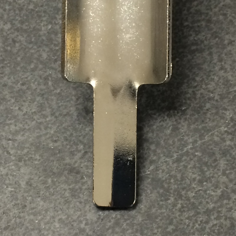

Everyone,
Thank you for your responses. This is good and very helpful information.
Quote (3DDave)
The primary control of orientation of the part is the cross-holes.
I'm basing this on the observation that the if the holes are misaligned by a small amount to the overall shape the overall shape will end up crooked in the handle. It looks like there is plenty of clearance in the width.
Dave, after reading your response we took another look at the hole alignment and sure enough we found variance. We happen to have two samples in the QC office. One sample had a variance of 0.020" and the second was relatively aligned; variance of 0.001".
Another observation we made - center line of curved part is NOT parallel to the flat part (see image below). It is almost centered on top and it's quite off at the bottom as it can be seen in the image.
It looks like the hole misalignment along with curved part not being parallel to the slot/flat section (0.416 dimension) is the cause of the problem.
