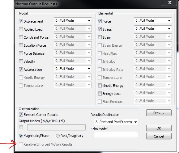

Blas: My option for Relative Enforced Motion Results is GRAY and so I cannot select it. I assume that I have made some other selection somewhere that is interfering with it. It is a modal frequency response using an applied acceleration (SPCD). Any thoughts?

RE: Random and Frequency Response Analysis Displ
Hello!,
Precisely this picture is from my blog where I run an enforced motion Modal Frequency Response (SOL111), ie, a Sine Frequency Swept under an enforced motion AY=0.25G in the frequency range between 0-500 Hz, here you are the post: https://iberisa.wordpress.com/2013/11/17/53-sine-v...
Hi Blas - I cannot select the option. See image.
Hello!,
I run NX NASTRAN solver. I note your firm say FEMAP v11.1.0 & MSC Nastran V2013, then this could be the reason??.
Probably! BURNT AGAIN BY MSC!!! smile
