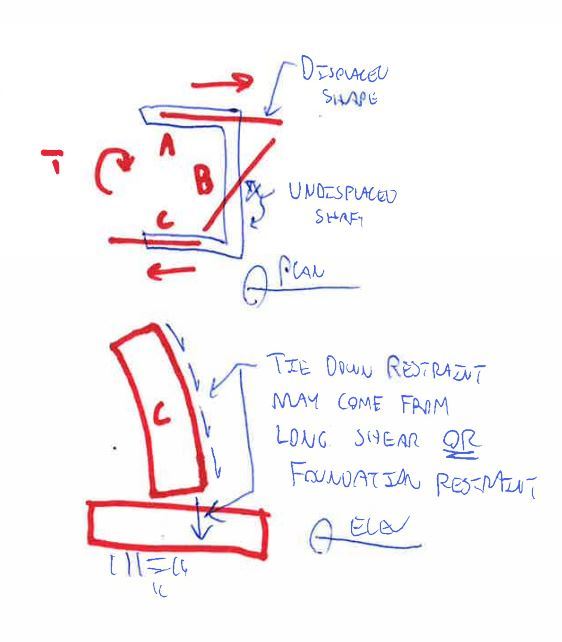

Open section shaft walls will resist torque primarily through warping torsion. If you google the works by Bungale Taranath, Alexander Coull, and Bryan Stafford, you'll find a wealth of information. It's complex stuff however. Sectorial coordinates and all that jazz.
If you've performed a 3D analysis that would capture warping torsion effects then you should see the longitudinal shear demand in the walls due to torsion showing up as a vertical shear loads on your individual wall panels. If so, that's the force that you can design to. To some degree, it also depends on your foundation modelling. If your walls are rigidly attached to a rigid foundation, that will affect things.

I'm not familiar enough with it that I can speak in terms of V1/M3/R2 etc. One way or another, the longitudinal shear forces connecting the individual wall panels of the composite shape must manifest themselves as vertical shear forces on the individual panels.
Quote (4D)
I think you are referring to the fact that warping tend to occur near rigid support where there is warping restraint, and free torsion more up top of building?? is that what you mean?
A shear wall is a vertical cantilever with some degree of warping restraint provided at the foundation. If that restraint is small, then the longitudinal shear demand on the wall joints will be larger. If that restraint is large, then the longitudinal shear demand on the wall joints will be smaller. See the sketch below.

Are you saying that the foundation takes some of the warping torsion away from the core, thus less torsion left in the core and thus, less longitudinal shear is demanded in the shear wall?
Close. The torsion in the cores should remain more or less unchanged. However, the foundation will limit the amount of torsional warping deformation experienced by the core.

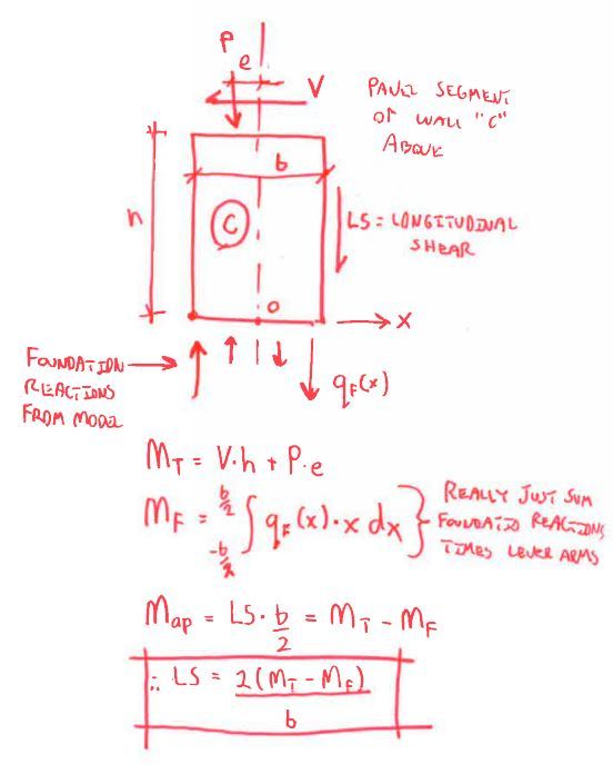

1) Each individual wall panel (shaft side) will have a total overturning moment (M_t) induced in it by the applied shear and axial loads. You should be able to extract this from your model.
2) Part of the overturning moment will be resisted by the foundation reactions (M_f). You should be able to extract this from your model.
3) Part of the overturning moment will be resisted by the shear connection to the adjoining panels (M_ap). If M_ap cannot be extracted directly from your model, calculate it as M_ap = M_t - M_f.
4) Use M_ap to work out the longitudinal shear demand at the panel joint. This value will include the requirement for shear transfer due to both flexure and torsion.

I don't think etabs can separate the load into M_t and M-f...or I still don't understand what they mean...M_t is created by shear and axial? im guessing that's the load from the diaphragm and gravity load..
I don't get M_f...resisting force (M_t) vs. overturning force (M-F)..im not sure i understand.

Yeah, it was probably a little optimistic/lazy of me to think that we could get by without a sketch here. My bad. Check out the sketch included below. It's really just equilibrium on the panel.
Quote (4D)
Precisely.
