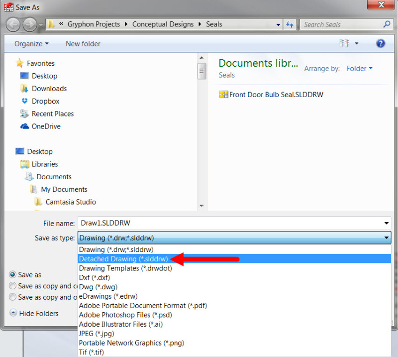

RE: SOLIDWORKS SLITED DRGS OPENING
File\Save As\ - Change type to Detached Drawing
Close the file out and reopen it. That's all you have to do. You should see a blue broken paper clip in the top of the tree after you save and reopen the detached drawing.
Thanks SBaugh!
Its really working fine...
