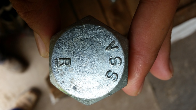

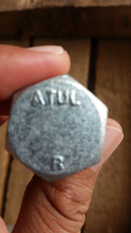

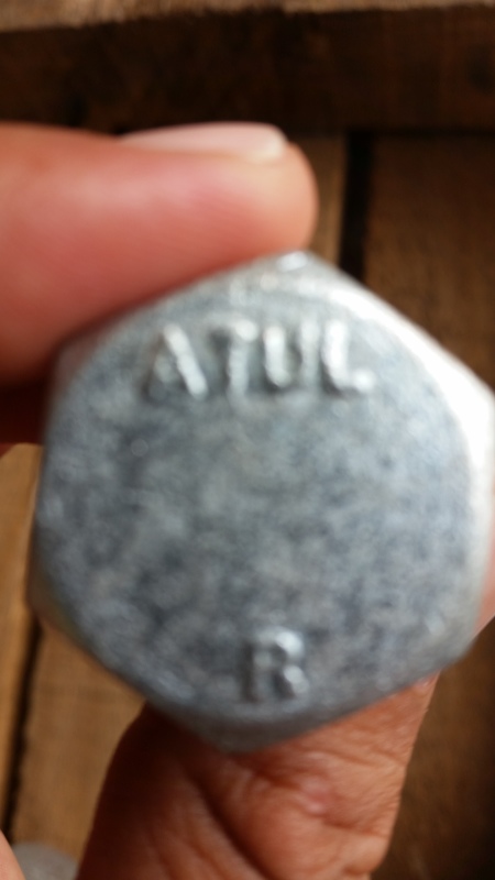

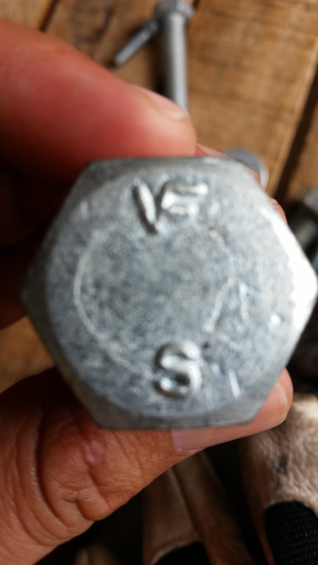

Its anyone familiar with this markings. This bolts came label as 4.6 8.8 10.9

By the way this bolts came from india, but we found some american manufacturer stamps in other bolt that i did not upload pictures for

Grade 8.8 bolts are high strength structural bolts, 800 MPa tensile strength, 640 MPa yield strength. The markings on the head should identify the manufacturer.

Yeah i was thinking that if that is the manufacturer stamp there is no way to know if the bolts are 8.8 so they should not be use unless the bolts are mark as 8.8
Is that correct?

I would not allow the use of bolts with unknown markings. There have been a lot of substandard structural bolts from China in recent times. I don't know about India.

By googling, I did find out that ATUL is an Indian bolt company. No such luck with the VSS marking.
