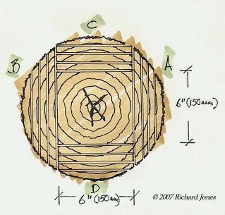

andriver - Great! For future reference, southern pine 6 x 6's make really terrible beams. It's where a 6 x 6 comes from in the tree - the center. The wood around the center develops longitudinal splits (checking). Also, since this member is from the center, limbs (knots) can be on all four sides... sometimes simultaneously. A better choice is an appropriate number of southern pine 4 x 6. We used only 4 x 6 for falsework of cast-in-place bridge slabs and high-pressure concrete forms (such as tall overpass crash-walls adjacent to railroad tracks).
See this link for information on 6 x 6s... so called "dog boards": Link
When designing with southern pine for temporary structures, I suggest sticking with the values for #2 grade. These days, there are few southern pines that are old enough to provide higher grades.
