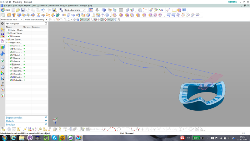

RE: How to create this cam in NX8.5: Good challenge for NX expert
Two law curve, one for inner radius, one for outer.
X=rcost
Y=rsint
Z=law curve from your scketch, no need to scale.

Hi Chigishev,
It seems to be the solution, but I didn't succeed: have a look to my part
Thanks in advance
Hi Meinolf
You are the winner thumbsup2
Thanks a lot
When designing cams it is common to specify the "dwell time" (time the follower is in a constant position) and "rise time" (time the follower is moving up or down). When the angular speed of the cam is known, you can talk in terms of time; however, it is common to use angles for the dwell time and rise time as this is independent of the speed of the cam. The sketch in the OP is 360 units long; therefore each single unit of length in the sketch represents one degree of cam travel. The linear dimensions are the ones that are important (they should be driving dimensions); they will govern the angular dwell and rise times of the resulting cam profile. The cam is divided into three identical 120° sections; each section starts with 52.2° of rise followed by 43.2° of dwell. The remainder of the 120° section falls back to the original position. The angular dimensions in the sketch are unimportant. By reworking the sketch and using the techniques shown by others above, you could allow easy user input of "rise time", "dwell time", and rise distance. This would allow easy, direct changes to the cam profile.
