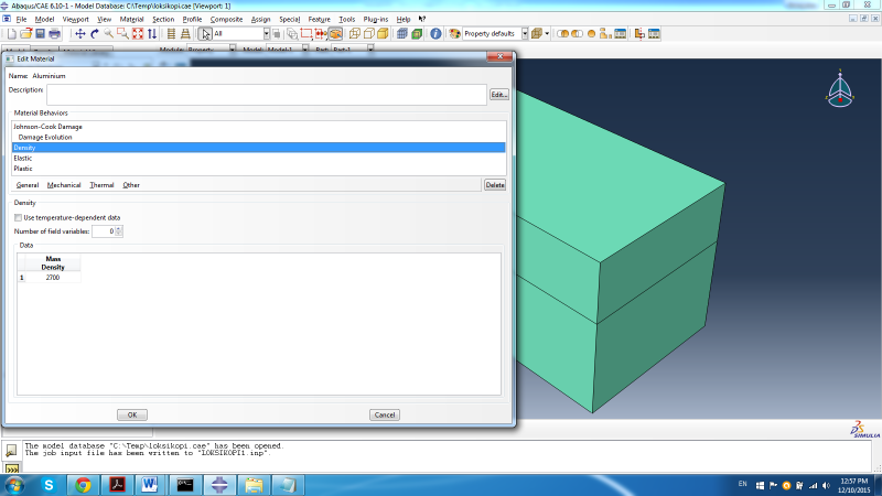

What element should I use in an orthogonal cutting simulation in order to view the chip formation?
In my simulation I use C3D8R but due to the STATUS parameter in the Field Output Request and the element deletion choice in the element type window
the deformed elements are instantly deleted and no chip is visible.
Any ideas?

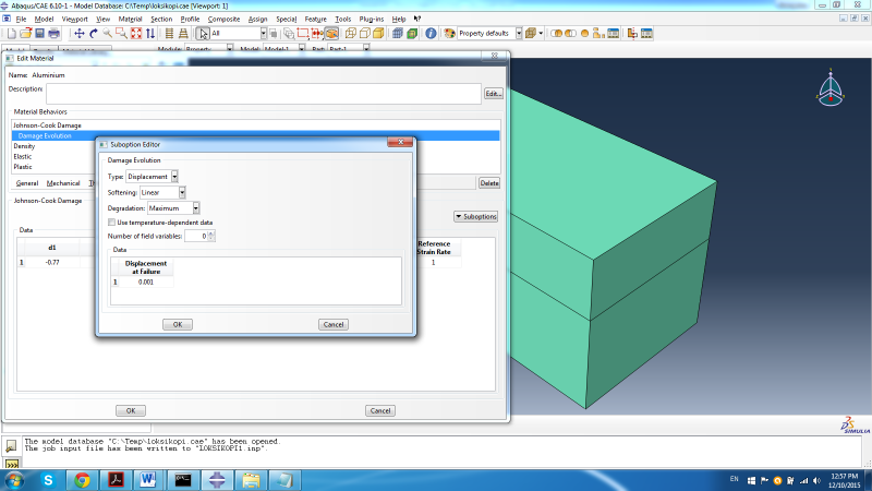

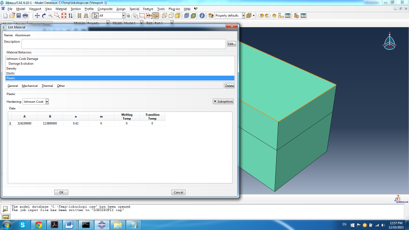

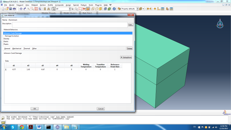

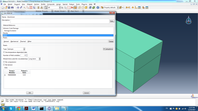

Thank you for your answer.
NLGEOM in the step definition is turned ON.
The material data were taken from a tutorial which has worked for a plethora of other simulations.

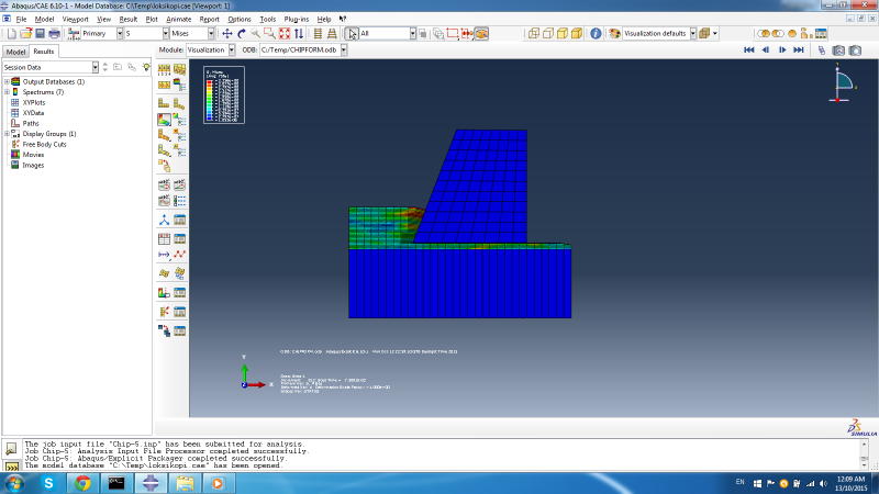

I even changed the seeds of the elements so the final mesh looks like this
I also changed the interaction because with this mesh no internal surface needs to be specified.
Yet no chip formation can be found and my elements are still being deleted.

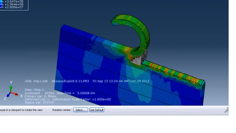

What I want to achieve is something like this
Any ideas?
