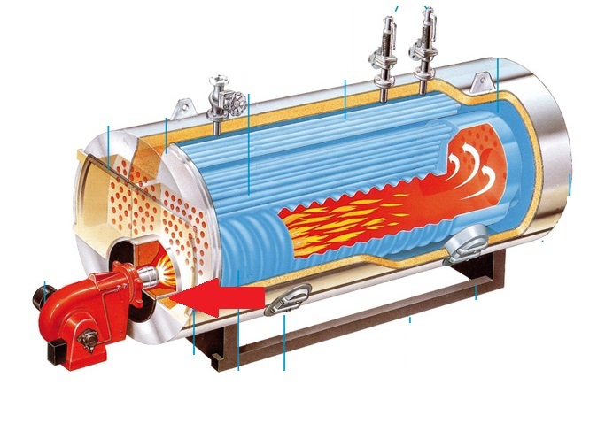

RE: Old boiler material
Sorry, I couldn´t find the words to explain it, maybe with a picture. The red arrow indicates this "ring" that I´m refering to, and yes, it has refractory in the same disposition as the picture. What you are suggesting makes sense to me.
