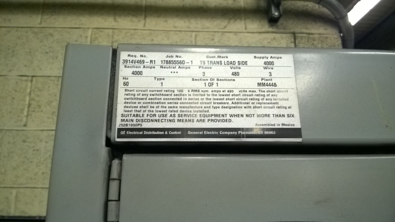

I just started as an electrical supervisor for a hot strip mill. On my first week we were coming up from an outage and a ground in a screw compressor motor tripped a 4000 amp breaker with GFI fault causing a loss of power in two entire departments.
This compressor is fed off a downstream load center but the older panel did have a chance to trip before the 4000 amp kicked. I want to prevent future nuisance trips and isolate the downstream issues. I have contacted the manufacture and they are looking up the build specs and going to see if they can recommend any add on equipment for our old load centers feeding off this main to catch the ground as close to the fault as we can.

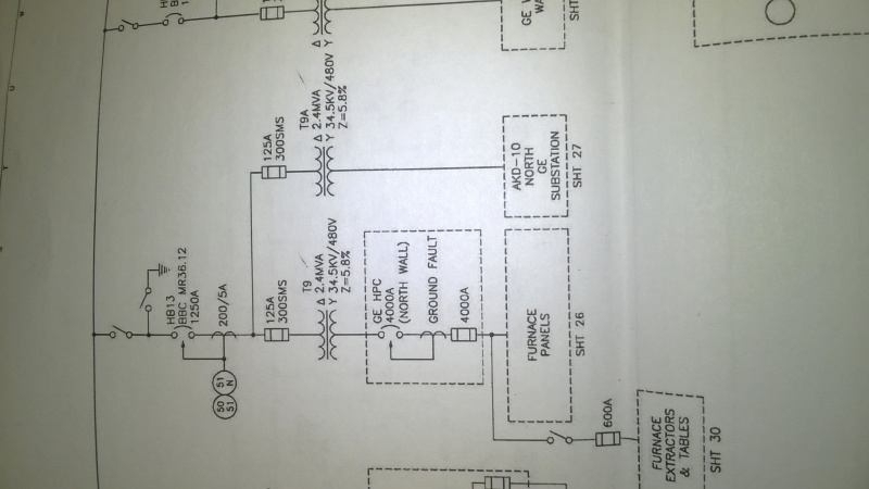

The 4000 amp breaker is the main on the secondary of one of our transformers. It is a 3 wire 480 volt system and it looks like they created an earth ground there for the GFI. I will look into it further, but I believe that it is either a wye - delta or delta - delta step down transformer.
In the code book it looks like you only need the GFI on a wye (4 wire) system above 1000 amps. They make no mention of using it on a 3 wire system. Is there something that I am missing or is it possible we ordered the GFI version when it was not necessary/required?

jraef: On the disconnect is says three wire 480. From my experience that is either a ungrounded delta or a floating wye on the secondary. On the line drawing it is T9. They are showing a Delta-Wye transformer and I believe that it is accurate. I will look to see if we have any wiring diagrams on the install itself. For now, I am under the assumption that there are three wires to the transformer and nothing connected to the center tap. We will have to wait for a downturn to physically inspect the breaker cabinet.
Parchie: I am going to have to think about that more. You raised some good points. From mill rumors I believe they created a ground point at the breaker for the GFP, but how would it sense it. I will have to read up on some GFP setups. I will update when I learn some more.

The problem may be a coordination issue.
We had a ground fault on a 30 Amp circuit. The cable had been disconnected at the load end. The three phase wires and the ground wire were twisted together and taped. A lock dog was installed on the 30 Amp GFI breaker feeding the cable.
An electrician (who no longer is employed at that plant was explaining to another electrician that that type of lock dog was not very effective and the breaker could be turned on despite the lock dog. He demonstrated by turning the breaker on. A 1200 Amp breaker went out on a ground fault trip. The plant was down for four hours while crews tracked down the cause and determined that it was safe to re-energize.
The 1200 Amp breaker had been installed "Out of the box". The default GFI setting was instantaneous. The settings were reviewed and a short time delay added to the GFI trip to allow co-ordination with downstream devices.
Your issue may be similar.
The three wire designation refers to the lack of a neutral. It does not imply an ungrounded system
The one line drawing shows a wye secondary winding. The wye point is almost certainly grounded.
With no line to neutral loads the ground method may be either a solid ground or an impedance ground.
