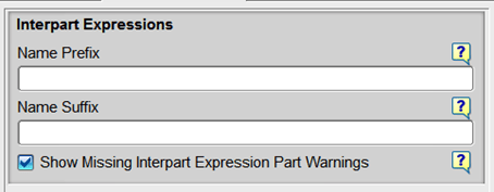

Now, in NX 10.0.3 and in NX 11, we're closing some gaps that we hadn't anticipated when we originally implemented these changes in NX 10.0.0:
  1. We're trying to be smarter about how we name the new "blue" IPEs, borrowing the name of the source expression where possible, and giving you a way to optionally include a suffix or prefix to these, if you like, to make it easier to recognize them as IPEs when they're used in other formulas:
  2. And to your specific question, Drew... With the loss of the ability to just edit the textual reference in the formula to redirect an IPE to a new parent, we're introducing a new UI for editing an IPE. It will be familiar, and as you'd expect, it will be as simple as choosing a new parent part and parent expression from within that part. In the meantime, a workflow in which you create a new "blue" IPE and then edit or replace references will be necessary until 10.0.3 or NX 11. Does that make sense?
And so the automatic conversion in NX 11 (and NX 10.0.3) looks more like this:
...or if you're using an "_ipe" suffix, for instance, like this:
[And yes, if you're paying attention, that's a little sneak peek of one part of the new NX 11 Expressions Dialog. smile ]
