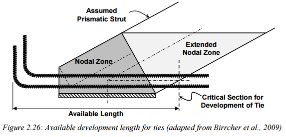

Quote (rapt)
fully develop it past the support centre at the ends as some design codes require (I know the Canadian code does not require it Kootk, but that does not mean they are right. Maybe Collins and Mitchell got one wrong!).
We have a version of this but it's not quite so stringent. Full development past the centre of support seems excessive to me. Even analyzed with STM, you'd only need to develop for required force past the interior face of the support.

Kootk, Depends on who does the STM. I would argue that development is required past the intersection of the compressive strut and the tension tie, which is normally the centre of the support! That is what is required by most design codes also.
RE: strut and tie modelling in precast deep beam/ wall
Quote (rapt)
Really? From what I've seen in the codes and literature in Canada, Europe, and the US, the length available for tie development always seems to be as shown below. It's the intersection of the interior edge of the compression strut and the centroid of the tie group and is well to the inside of the bearing centerline.
