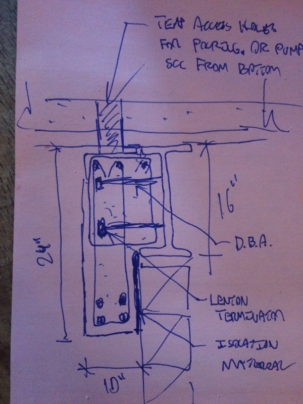

New Information:
I was on site again this morning and found that the block wall is not directly under the beam but about 2" clear of it. This suggests to me that the best thing would be to weld a tee section to the soffit of the beam. It is I suppose overhead welding, but is that really so difficult/expensive? The welding would have to be done from one side only, but if a continuous backer bar were welded to one side of the web of the tee before it was lifted into place, then I would think that a full penetration butt weld could be made from one side only. What do you think?

Can the existing 2.5" of dry pack grout between the top of the steel beam and the soffit of the waffle slab ribs (that run at 90 degrees to the steel beam span, at 2 foot centres) be considered as lateral support for the steel beam? I don't think so, but someone suggested to me that it might.
RE: Reinforcing steel beam
And a further question: Should we jack the slab up say 1/4" to take some of the load off the steel beam before welding the new steel reinforcement to the beam, or is that not necessary? Have to be careful not to do more harm than good (such as making more cracks in the block wall that sits on the floor here, although we would monitor the movement with dial gauge. I have jacked up a wood floor about 1/2" a few years ago and it came out quite well, but there were not much brittle materials involved).

I picture it as a somewhat complicated problem. Your existing steel has stress/strain in it. If you attach the reinforcing to it, and assume the current stress/strain remains in the member, when it takes more load there is potential for the original member to begin to plasticize much sooner than the reinforcement. But if this happens, the greatly increasing strain in the existing member is restrained by the new reinforcing that may still be elastic - so perhaps it starts to dump extra load into the reinforcing due to the differing strain rate at the interface? Basically though, I think its generally OK to not jack the member due to the large ductility of steel. In the US at least we tend to hold L/600 or 0.3" (the more stringent) for something supporting masonry to help prevent cracking.

I'd lean towards not jacking the beam to avoid damage to the existing block wall. And I'd prefer a more positive lateral restraint for the top of the beam. Maybe you can tie back to a few of the perpendicular ribs.

to Kootk: I agree with what you say. It will apply to a number of beams and may happen at other floors up the building. Anyway, if that is what has to be done, that is what will have to be done, but we will have to check the situation on the other floors. Maybe the beams are not as heavily loaded. It would be interesting if anyone has ever done a load test for this condition to see if the beams buckle laterally.
