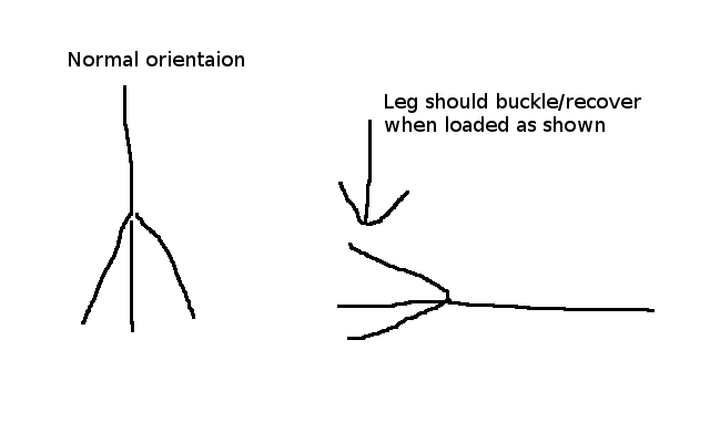

It's basically a monolithic tripod with a pedestal on top. About 45cm overall height, and the base fits within a 35cm diameter circle. The tripod legs stop about 1/3 of the way up.
Outdoor use all over the world
by occasionally angry/competitive athletes
should survive being landed on (ideally can be crushed and will spring back -- can have warping, stretch marks, etc. after)
paintable and bondable
Premium consumer grade materials are OK (the product is for high-end consumers, so some cost is acceptable. Ideally a cheap, common consumer product resin, though).
If the unit is tipped over one leg will be pointing up. From a safety standpoint this leg needs to buckle under the weight of a human body. From a customer satisfaction standpoint, it should spring back to at least usable shape (keeping the cosmetics would be a bonus) after unloading. This will be a rare event, but it will almost certainly happen.
I had a recommendation for Nylon 6/6 before the buckling requirement was added, and another recommendation for an ABS/PP blend after. Do either of these sound reasonable? Alternatives I should consider?

Is it the tripod legs that need to recover?

Pud: Yes, the leg needs to buckle when loaded from the side. And preferably recover. I've attempted to attach an image which should clarify things.

Have a look at amorphous Nylon 11* or Nylon 12*. They tend to be fairly stiff but have a very good recovery when strained. They are also have very good chemical resistance and can be got with UV stabiliser in. A very hard (Durometer hardness) polyurethane might also work.
Perhaps extruded tubing with a rigid joining piece? All will be available in extrusion grades as it's used for oil pipelines amongst other things.
* e.g. PA11 = "Rilsan" trade name, PA12= "Grilamid TR90UV" and there are others.

I'd be looking at urethanes, quite honestly. Most nylons and ABS blends would make a very neat improvised bayonet, which is not desirable.

I like the idea of using urethane. Assuming the material is chosen properly it seems like it will always get out of the way as well as spring back like we want. I'm currently looking into the costs to make the lower portion out of urethane or some other semi-stiff rubber. The product 'snaps' together using a slip fit joint just above where the 3 legs meet. I don't think that will work with rubber on one side, so we would either need to do an overmold or bond the rubber to a rigid plastic fitting.

Our mold shop says they can do a SEBS overmold in a harder durometer, and I think the cost is manageable.
I'm currently wondering if I should be worried about creep. These will in some instances be sitting out all day in hot parking lots, and while they don't weigh that much the elevated temperatures might be a problem. Wouldn't want them to 'wilt'. :)
Should I be worried? Looks like there are some additives or certain formulations that have improved creep resistance. As near as I can tell the UV resistance is good already.
