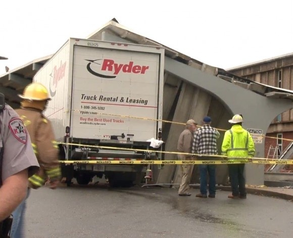

Box truck hit the concrete canopy structure. 25 injured.
Quote (ABC News)
Iredell-Statesville Schools spokeswoman Susie Wiberg said the students were standing under the awning as a band competition was about to get started inside the school. Wiberg said a box truck hit one of the canopy supports and the awning then fell, hitting the students underneath it. A driveway leads up to the canopied entrance.

Another collection of precast concrete parts, poorly tied together. A truck like that should not bring down a substantial awning. A steel awning should bend but not break, and a concrete awning should punish the truck but remain standing.
RE: Collapse of Concrete Awning at School in North Carolina
Looking at the pictures in the link it looks like the truck took out one of the concrete arches. I don't think whether it's precast panels or steel deck it can withstand losing an interior support like that.
But, yes, precast does tend to lack the redundancy of steel deck.

There was a "CAUTION" sign on that first column, but I can't read what it said. If it was a height warning, it was badly placed.

If I'm looking at the right location on Google maps, it looks like a place where school buses would logically be driven through on occasion. But there doesn't seem to be any warning-bar thingy between it and the road.
