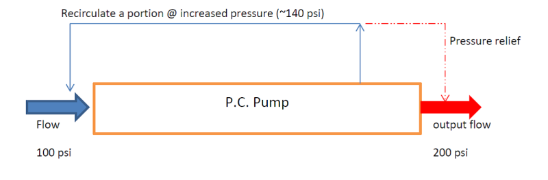

I have read in several studies that a multi-stage progressing cavity pump does not equally share the differential loading. The work done by the first couple of stages is virtually zero, and then the remaining couple increases exponentially. It is almost to the point it is ridiculous to spend the money on the additional stages. Being a subscriber to the "Kaizen theory" about life and making things better, I started to research things a little more.
There are a several solutions regarding this phenomena.
~Solutions such as increasingly less interference between the rotor and stator from the inlet to discharge ends.
~Drilling holes in the rotor complete with check valves to assist in the load equalization.
~Modifying the design so that it becomes a "progressive" cavity, fusto-conical, etc....
I was curious if recirculating a portion of the higher pressure fluid near the final stages of the pump (discharge end) back into the inlet side would serve as a possible option. I'm curious if there would be any positive results by making such a modification.

RE: question on modification of a moineau type pump
I cannot imagine why you think any of the modifications you suggest would have any benefit. The only reason these PC pumps have more than one "stage" is to introduce more seals between the input and the output, which allows higher output pressure. There is zero compression in any "stage".

The idea was to recirculate the increased pressure back into the inlet side. However I have several concerns.
1. The possibility it would go into self-destruct mode by continually recirculating increased pressure, so the Pressure relief valve may prevent that.
2. Is the lower volume of recirculated fluid (approximately 20%), albeit a higher pressure, substantial enough to increase the overall working pressure of the initial stages of the pump?
Here's a rough sketch...The numbers are merely examples.
The thought is to increase the pressure capability of the pump, by improving the work load performed by all the stages, and not just the last few. In theory, this should allow for more differential pressure across the pump and thus shift the torque curve accordingly.
The idea may be totally crazy and not work, that's why I came to the brain trust.
I'm with you BIMR, the extra stages while not a total ruse, it's not worth the added costs. Unfortunately, what I have seen, is that all the vendors know of this phenomena and have spent lots of money studying it. A solution may just not be feasible, and it's just an idiosyncrasy that we have to live with. I'd be happy if I could achieve a 15%-25% improvement. It would be substantial for our application.

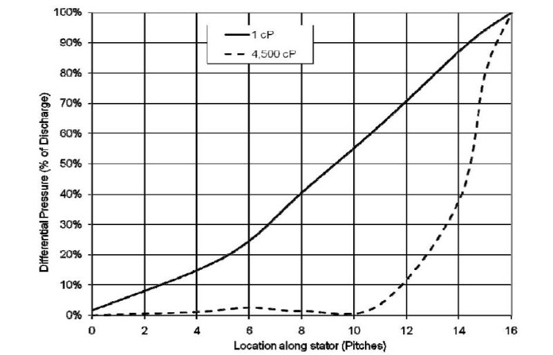

Here's an actual graph of measured loading across each pitch/stage. Some specific applications can run relatively high visc. fluid, however not on the order of 4500 cP.

I don't understand the little flowchart. When the pump is in fact a motor, shouldn't inlet pressure be higher than outlet pressure?
Where do you get the fluid for recirculation from? Does your PC motor have an outlet along the casing? Can you point us at some monufactuerers info on the PC motor you are using so we can see the thing?

PC pumps have been used for years as "mud motors" in directional drilling tools; nothing novel here.
In general the reason for additional stages is to inhibit the inevitable "slip" of product from one chamber to the adjacent, lower pressured chamber. Each stage added helps to spread the pressure drop and lower what each stage has to handle.
You can also accomplish the same thing by tightening the clearances between rotor and stator, or hardening the softer stator. But then you encounter wear problems by not allowing the softer stator to "absorb" hard particles as the rotor rolls over it. Also there will be much more expensive machining costs to produce the tighter tolerances and reliability reduction.
This whole idea sounds like a very academic exercise that should remain within academia.

DubMac has hit the nail on the head. As I suspected, the motive fluid is drilling mud, not a clean fluid, which is why the progressive cavity design is being used as a motor. I don't think that either check valves or closer tolerances are going to do you much good with that fluid in practical terms, if reliability matters. As I said, either the fluid is clean and you've selected the wrong type of motor, or the fluid is an aggressive one and your options for changing the progressive cavity design in meaningful, durable ways will be quite limited by that fact.

Inspection of the pump curve present above would predict the same. If you eliminated the first 10 pitches, you would have a 6 stator pump. The curve shows zero flow for a stator pump.
If you left off the last 6 stators, you would also have zero flow, from a 10 stator pump.
