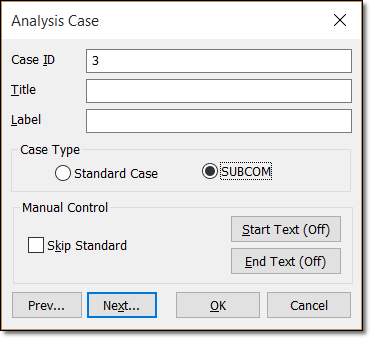

Hi.
I want to use the SUBCOM option to define a combined loadcase. (see http://www.eng-tips.com/viewthread.cfm?qid=351872)
However, the optionbutton is grayed out:
We're talking about a static analysis here.
I hope you can help me! It would save me a lot of time, everytime I edit a load definition I have to define the combined loads all over again.
Cheers

Hello!,
For Linear Static Analysis in NX Nastran, you have the choice of creating a “Stan­dard Case” or a “SUBCOM”, which is a combina­tion of other Subcases defined in your model.
You can use the SUBCOM command to create new subcases by combining other subcases. If not subcases exist, then SUBCOM is grayed.

I got it! I did not have any subcases defined. I also just found out you can create a new subcase without the multiset command.

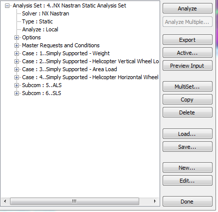

So I have another question now:
Is it possible to run te analysis and only get output sets from selected cases?
See image below. I only want ALS and SLS output, I do not want the analysis to run case 1 to case 4. However, I do not think I can delete case 1 to case 4? Because the Subcoms use this cases?
Thank you in advance!
