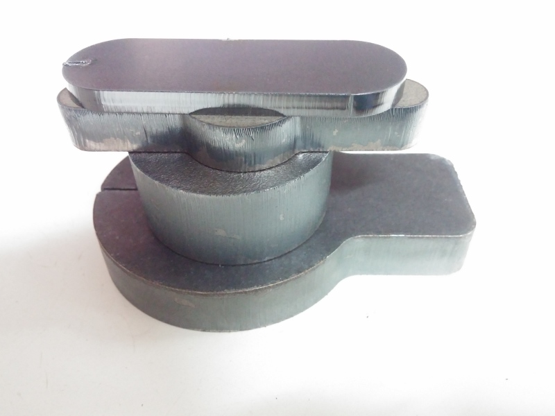

This is our cut on heavy plate, the 3/8 is a bit rough so we're cleaning the optics today. If I find out the parts are going to the other departments with dross on them I will make the laser operators clean them. One of the first things I drill into the laser department is we have to have a clean cut dross free because our customers paid for it. Now some materials you just can't cut real clean so you do the best you can but mild steel should always be clean. Who is you Amada rep? Do you do your own maintenance?
RE: Amada FO-3015 NT. Eco Swap
Beautiful cuts sir. i have my stainless steel and my HRS all dialed in very beautiful. However our Galvaneel* just always leaves a little dross from the coating or something im not sure. it warps and curls a lot though so we always have to watch for cutting head collision. we do have maintenance plan. Our rep is Mark Abrook. They are very good to deal with for sure. I was the programmer of this machine for 7 years before we had to down size and I inherited everything with it so I'm self taught on everything just reading the books and forums trying to tread water. haha. But i believe it can cut our GNL steel better even though we have the low pressure ez cut. Maybe im just a dreamer lol

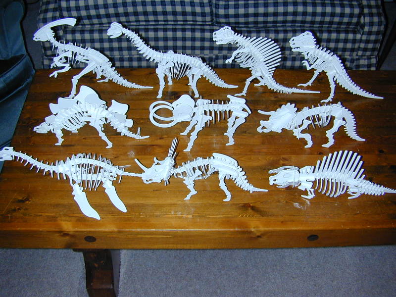

I made these from 18 ga Galvannealed steel. When I cut my 18 ga Galvannealed I used a 3.75" focus lens and treated it like stainless. I used 5kg of nitrogen with a 3.0 nozzle and the cut was great. Have you used the stainless cut conditions to see how it would work? One trick that works on the warping is to double tab the part but make sure to put them on opposite sides and as close to the middle of the part. I've been doing it all for over 20 years so if you need help and tricks I should be able to help I know the machine inside and out along with programming.

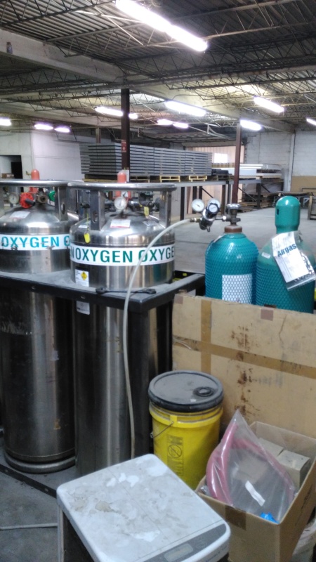

Awe yes the membrane, Yeah we had to replace that and all the coal inside back in June. That was a dirty job for sure. I had it cutting a lot better before the membrane swap though. Then we had turbo blower motor replaced, and a Chiller Pump rebuilt, and our internal Tracking cable busted so we had to go external and then the Tech accidentally statically fried our board because he forgot his ground straps... so we had to get that re done and... well it has just been a very long summer to say the least.
We did run straight Nitro once. they told us just hook it up and we ended up freezing the whole dang thing all the way to the head. That was 6 years ago. Yeehaw

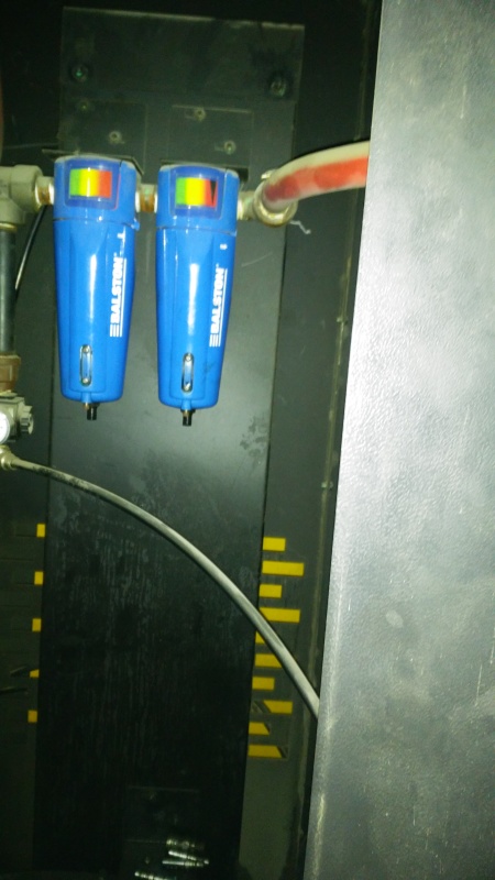

This system has been great for us.

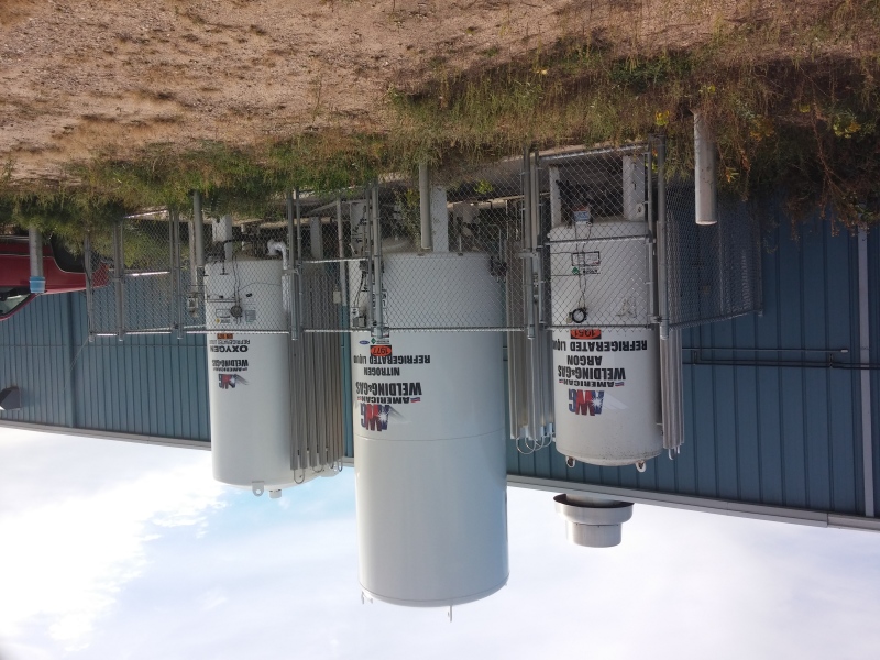

That chart is awesome thank you so much! Yea i will upload pics of our set up tomorrow morning. Its a fraction of what you guys are running. We manufactor skateparks and safe rooms though so it gets the job done but id be stoked if i could make it better..
Some time ago that was just like our shop. At one time we had so much 3/8 stainless to cut we had 3 tanks piggybacked and a full truck outside so we could refill them. It sounds like you’ve done a good job with things so keep it up and if you need any help just ask the people here are great.
